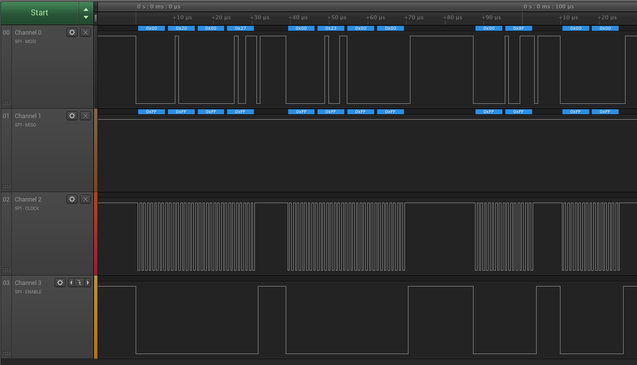

Hi all,
I am currently working on an SPI read function to pull data from an accelerometer (AIS328DQ) and am not able to see any traffic on the MISO line. I am able to see the correct traffic on the MOSI line where I am attempting to read from a specific address, but the MISO line is 0xFF when the correct value I should see according to the datasheet is 0x32. I have pasted my code below and also the screenshot from my logic analyzer

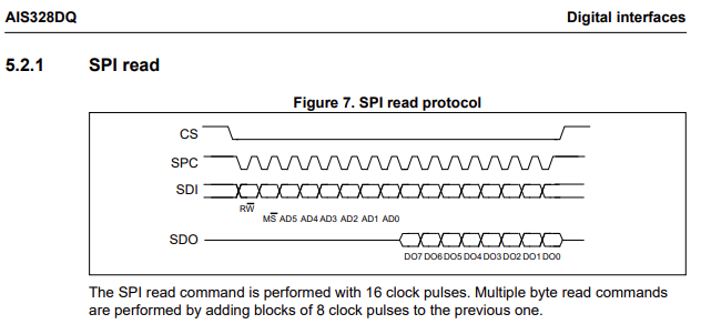

    The AIS328DQ datasheet shows that the CS must remain low for the entire read or write transaction. E.g.:
    And the AIS328DQ only drives SDO on the second set of 8 clock pulses when CS is low.
    Whereas your LSA capture shows "SPI ENABLE":
    • goes low for the first byte
    • goes high
    • goes low for the second byte
    As a result I think the AIS328DQ will never drive the MISO signal.
    Since the AIS328DQ uses 16-bit transfers, and the TM4C123GH6PM asserts FSS for one frame, try setting the SPI to use a 16-bit frame by changing the SSIConfigSetExpClk() ui32DataWidth argument to 16. I.e.:
       SSIConfigSetExpClk(SSI2_BASE, SysCtlClockGet(), SSI_FRF_MOTO_MODE_3, SSI_MODE_MASTER, 1000000, 16);

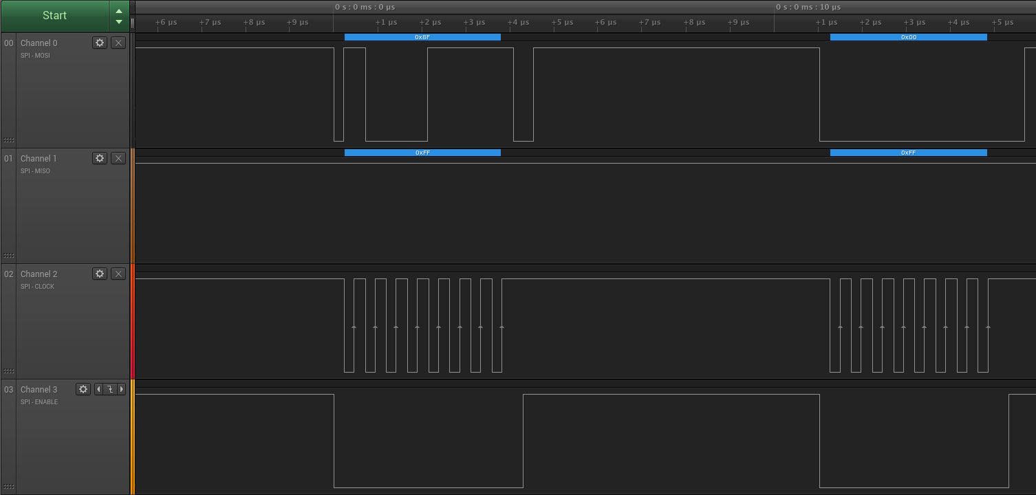

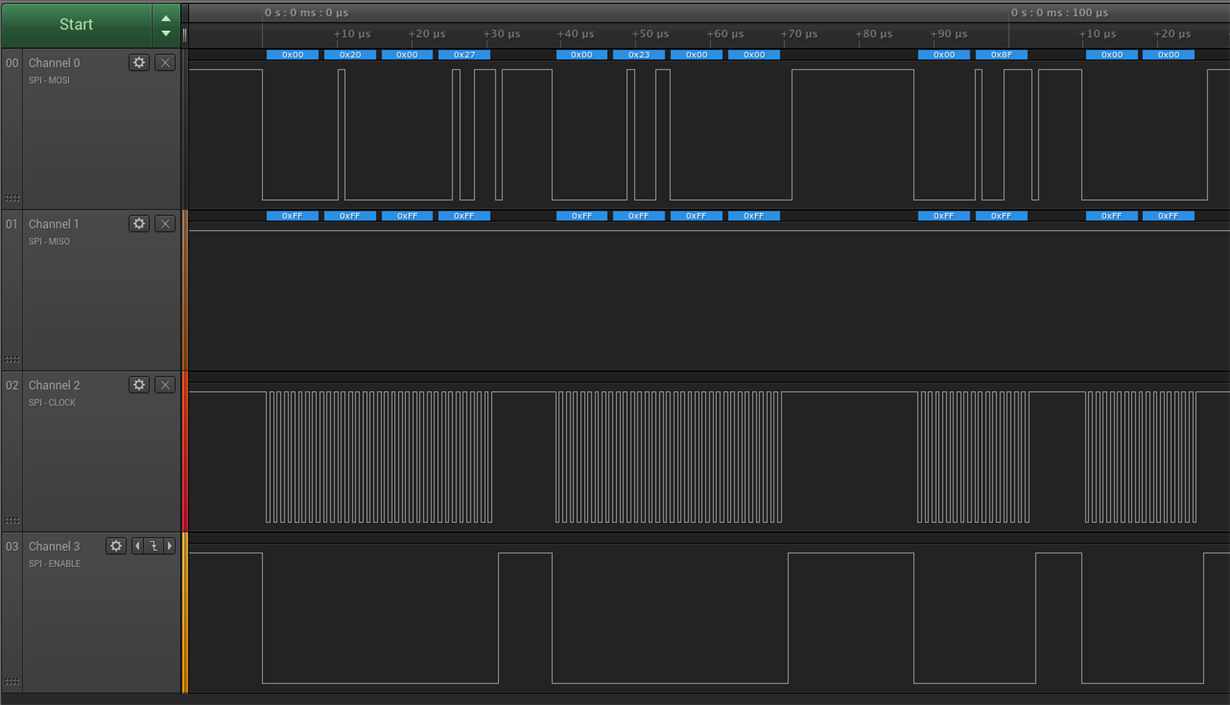

  • I changed the DataWidth parameter but am getting some interesting results from the logic analyzer. The MSB is sent first and since the TivaWare function parameters for SSI transmit and receive use 32 bits (not sure why when the fifo length is 16 bits), there is 0's being sent first, then my data. Attached is the screenshot.
    The data sent should be 0x20 0x27 instead of 0x00 before each byte.
    At this point I have typecasted everything to uint8_t, but still gets this result.
    When the data width is 16-bits then the SSIDataGet() and SSIDataPut() functions operate on 16-bits at once. I.e. you will need to change your code to call SSIDataPut() and SSIDataGet() once for each 16-bit transfer for the AIS328DQ. See the following notes for the functions:
    24.2.2.10 SSIDataGet
    Note:
    Only the lower N bits of the value written to pui32Data contain valid data, where N is the data width as configured by SSIConfigSetExpClk(). For example, if the interface is configured for 8-bit data width, only the lower 8 bits of the value written to pui32Data contain valid data.
    24.2.2.12 SSIDataPut
    Note:
    The upper 32 - N bits of ui32Data are discarded by the hardware, where N is the data width as configured by SSIConfigSetExpClk(). For example, if the interface is configured for 8-bit data width, the upper 24 bits of ui32Data are discarded.
