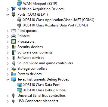

MSP432 LaunchPad is connected to my laptop (Dell Workstation, Windows 10, 64bit) through a powered USB2 Hub to the USB3 port on laptop. I can see TI Debug Probes and two COM ports generated by XDS110 as shown in the second picture attached. My LaunchPad was programmed with another computer earlier and as of now it communicates well with my laptop through User UART (COM4 on my laptop). But the problem is I cannot program it with CCS on my laptop since it cannot connect to the XDS110 on the board.

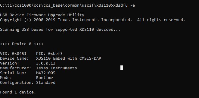

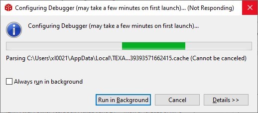

  • Thank you for prompt response! I did manual firmware update to the XDS110 on MSP432 LaunchPad. It was version 3.0.05, now it's updated to 3.0.0.13 as shown in the picture attached. So, the command line tool xdsdfu can find the XDS110 on USB and can update its firmware. But then in CCS, again creating a empty CCS project with the bare minimum main.c, then still the test connection on the targetConfigs page will hang for ever. Restart CCS, click debug button for the CCS project, then the CCS software hangs for ever at the Configuring Debugger stage as shown in the 2nd picture. I tried to lauch targetConfigue manually as shown in the links that you provided, but again it stalls as well.
