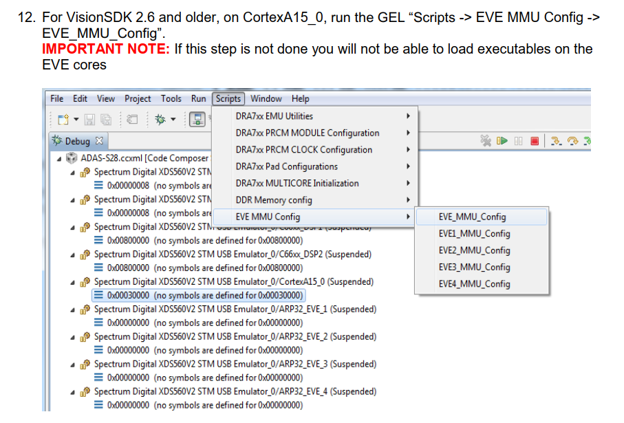

hi,
I am using the emulator to debug PROCESSOR_SDK_VISION_03_08_00_00.

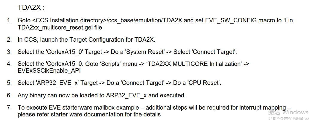

The description in the guidance document is this:

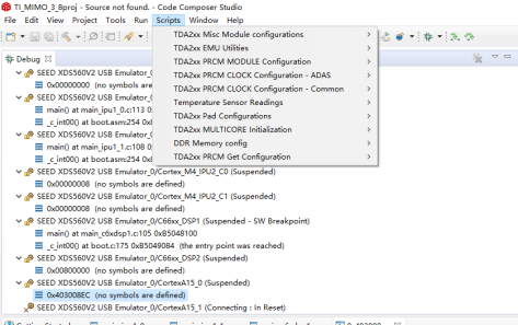

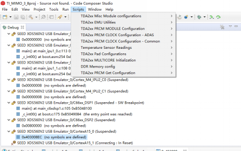

But I do not see EVE MMU config option in the Scripts menu:
there is an Error when loading the EVE executable code:
Please help me solve this problem, thank you.

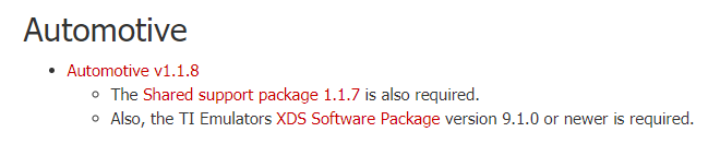

      Have you installed device support files for Automotive from the below location  :
    http://processors.wiki.ti.com/index.php/Device_support_files
    Anshu
    I have installed the device support file:
    but the error still exists.

      Have you followed below steps as mentioned in eve_sw_getting_started :
    Anshu
  • Hi Anshu,
    I did exactly the following steps:

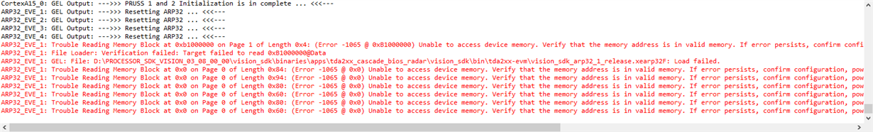

    The problem still exists.The error message is:
    ARP32_EVE_1: Trouble Reading Memory Block at 0xb1000000 on Page 1 of Length 0x4: (Error -1065 @ 0xB1000000) Unable to access device memory. Verify that the memory address is in valid memory. If error persists, confirm configuration, power-cycle board, and/or try more reliable JTAG settings (e.g. lower TCLK). (Emulation package 8.3.0.00003)
    ARP32_EVE_1: File Loader: Verification failed: Target failed to read 0xB1000000@Data
    ARP32_EVE_1: GEL: File: D:\PROCESSOR_SDK_VISION_03_08_00_00\vision_sdk\binaries\apps\tda2xx_cascade_bios_radar\vision_sdk\bin\tda2xx-evm\vision_sdk_arp32_1_release.xearp32F: Load failed.
    Looking forward to your reply,thanks.

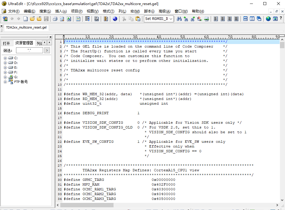

         Looks like some MMU configuration is not happening correctly. Can you again confirm if you have set EVE_SW_CONFIG macro to 1 in TDA2xx_multicore_reset.gel file?
    Anshu
  • hi Anshu,I have  set EVE_SW_CONFIG macro to 1 in TDA2xx_multicore_reset.gel file,like this.
    Thanks,waiting for your reply.
  • the error message like this,when I load code to the EVE
       Can you share the following two files :
    • "C:\ti\<ccs>\ccs_base\emulation\gel\TDA2x\TDA2xx_multicore_reset.gel"
    • Linker command file used for your application.
    Anshu

    #define EVE2_MMU0_BASE               (EVE2_TARG + 0x81000)
    #define EVE2_MMU1_BASE               (EVE2_TARG + 0x82000)
            EVESS3 Address Map defines: CortexA15_CPU1 view
    #define CM_EVE3_CLKSTCTRL            (EVE3_CM_CORE_AON + 0x0)
    #define CM_EVE3_EVE3_CLKCTRL         (EVE3_CM_CORE_AON + 0x20)
    #define RM_EVE3_RSTCTRL              (EVE3_PRM + 0x10)
    #define RM_EVE3_RSTST                (EVE3_PRM + 0x14)
    #define EVE3_MMU0_BASE               (EVE3_TARG + 0x81000)
    #define EVE3_MMU1_BASE               (EVE3_TARG + 0x82000)
            EVESS4 Address Map defines: CortexA15_CPU1 view
    #define CM_EVE4_CLKSTCTRL            (EVE4_CM_CORE_AON + 0x0)
    #define CM_EVE4_EVE4_CLKCTRL         (EVE4_CM_CORE_AON + 0x20)
    #define RM_EVE4_RSTCTRL              (EVE4_PRM + 0x10)
    #define RM_EVE4_RSTST                (EVE4_PRM + 0x14)
    #define EVE4_MMU0_BASE               (EVE4_TARG + 0x81000)
    #define EVE4_MMU1_BASE               (EVE4_TARG + 0x82000)
                EVESS CPU Independent defines
    #define CM_EVE_CLKSTCTRL             ((cpu_num == 1) ? (CM_EVE1_CLKSTCTRL) : ((cpu_num == 2) ? (CM_EVE2_CLKSTCTRL) : ((cpu_num == 3) ? (CM_EVE3_CLKSTCTRL) : (CM_EVE4_CLKSTCTRL))))
    #define CM_EVE_EVE_CLKCTRL           ((cpu_num == 1) ? (CM_EVE1_EVE1_CLKCTRL) : ((cpu_num == 2) ? (CM_EVE2_EVE2_CLKCTRL) : ((cpu_num == 3) ? (CM_EVE3_EVE3_CLKCTRL) : (CM_EVE4_EVE4_CLKCTRL))))
    #define RM_EVE_RSTCTRL               ((cpu_num == 1) ? (RM_EVE1_RSTCTRL) : ((cpu_num == 2) ? (RM_EVE2_RSTCTRL) : ((cpu_num == 3) ? (RM_EVE3_RSTCTRL) : (RM_EVE4_RSTCTRL))))
    #define RM_EVE_RSTST                 ((cpu_num == 1) ? (RM_EVE1_RSTST) : ((cpu_num == 2) ? (RM_EVE2_RSTST) : ((cpu_num == 3) ? (RM_EVE3_RSTST) : (RM_EVE4_RSTST))))
    #define EVE_MMU0_BASE                ((cpu_num == 1) ? (EVE1_MMU0_BASE) : ((cpu_num == 2) ? (EVE2_MMU0_BASE) : ((cpu_num == 3) ? (EVE3_MMU0_BASE) : (EVE4_MMU0_BASE))))
    #define EVE_MMU1_BASE                ((cpu_num == 1) ? (EVE1_MMU1_BASE) : ((cpu_num == 2) ? (EVE2_MMU1_BASE) : ((cpu_num == 3) ? (EVE3_MMU1_BASE) : (EVE4_MMU1_BASE))))
    #define EVE_MMU_PAGESIZE_1M          0
    #define EVE_MMU_PAGESIZE_64K         1
    #define EVE_MMU_PAGESIZE_4K          2
    #define EVE_MMU_PAGESIZE_16M         3
    #define EVE_MMU_BASE                ((mmu_num == 0) ? (EVE_MMU0_BASE) : (EVE_MMU1_BASE))
    #define EVE_MMU_SYSCONFIG           ( EVE_MMU_BASE + 0x10 )
    #define EVE_MMU_SYSSTATUS           ( EVE_MMU_BASE + 0x14 )
    #define EVE_MMU_CNTL                ( EVE_MMU_BASE + 0x44 )
    #define EVE_MMU_FAULT_AD            ( EVE_MMU_BASE + 0x48 )
    #define EVE_MMU_CAM                 ( EVE_MMU_BASE + 0x58 )
    #define EVE_MMU_RAM                 ( EVE_MMU_BASE + 0x5c )
    #define EVE_MMU_LOCK                ( EVE_MMU_BASE + 0x50 )
    #define EVE_MMU_LD_TLB              ( EVE_MMU_BASE + 0x54 )
    #define EVE_MMU_EMU_FAULT_AD        ( EVE_MMU_BASE + 0x70 )
            IVASS Address Map defines: CortexA15_CPU1 view
    #define CM_IVA_CLKSTCTRL             (IVA_CM_CORE + 0x0)
    #define CM_IVA_IVA_CLKCTRL           (IVA_CM_CORE + 0x20)
    #define CM_IVA_SL2_CLKCTRL           (IVA_CM_CORE + 0x28)
    #define RM_IVA_RSTCTRL               (IVA_PRM + 0x10)
    #define RM_IVA_RSTST                 (IVA_PRM + 0x14)
    #define ICONT1_ITCM                  (IVA_CONFIG_TARG + 0x08000)
    #define ICONT2_ITCM                  (IVA_CONFIG_TARG + 0x18000)
    menuitem "TDA2xx MULTICORE Initialization"
    /************ Enable all slave cores ***************/
    hotmenu TDA2xx_MULTICORE_EnableAllCores()
        IPU1SSClkEnable_API();
        IPU2SSClkEnable_API();
        DSP1SSClkEnable_API();
        DSP2SSClkEnable_API();
        EVE1SSClkEnable_API();
        EVE2SSClkEnable_API();
        EVE3SSClkEnable_API();
        EVE4SSClkEnable_API();
        IVAHDSSClkEnable_API();
        PRUSS_1_2_ClkEnable();
    /************ Enable the PRUSS Clocks **************/
    hotmenu PRUSS_1_2_ClkEnable()
        GEL_TextOut("--->>> PRUSS 1 and 2 Initialization is in progress ... <<<---\n");
        WR_MEM_32(0x4a009718, 0x0); //PRUSS_1_CLKCTRL
        WR_MEM_32(0x4a009720, 0x0); //PRUSS_2_CLKCTRL
        WR_MEM_32(0x4a009718, 0x2); //PRUSS_1_CLKCTRL
        WR_MEM_32(0x4a009720, 0x2); //PRUSS_2_CLKCTRL
        while ((RD_MEM_32(0x4a0098FC) & 0x100) != 0x100); //L4PER2 - ICSS_CLKACTIVITY
        GEL_TextOut("--->>> PRUSS 1 and 2 Initialization is in complete ... <<<---\n");
    /************ Enable the IPU1 Clocks ***************/
    hotmenu IPU1SSClkEnable_API()
        IPUSSClkEnable(1);
    /************ Enable the IPU2 Clocks ***************/
    hotmenu IPU2SSClkEnable_API()
        IPUSSClkEnable(2);
    /************ Enable the DSP1 Clocks ***************/
    hotmenu DSP1SSClkEnable_API()
        DSPSSClkEnable(1);
    /************ Enable the DSP2 Clocks ***************/
    hotmenu DSP2SSClkEnable_API()
        DSPSSClkEnable(2);
    /************ Enable the EVE1 Clocks ***************/
    hotmenu EVE1SSClkEnable_API()
        EVESSClkEnable(1);
    /************ Enable the EVE2 Clocks ***************/
    hotmenu EVE2SSClkEnable_API()
        EVESSClkEnable(2);
    /************ Enable the EVE3 Clocks ***************/
    hotmenu EVE3SSClkEnable_API()
        EVESSClkEnable(3);
    /************ Enable the EVE4 Clocks ***************/
    hotmenu EVE4SSClkEnable_API()
        EVESSClkEnable(4);
    /************ Enable the IVA Clocks ***************/
    hotmenu IVAHDSSClkEnable_API()
        IVAHDSSClkEnable();
    IPUSSClkEnable(uint32_t cpu_num)
        uint32_t regVal, regAddr;
        GEL_TextOut("--->>> IPU%dSS Initialization is in progress ... <<<---\n",,,,, cpu_num);
        /* Reset asserted for IPU CPU0, CPU1, Unicache and MMU */
        WR_MEM_32(RM_IPU_RSTCTRL, 0x7);
        /* Reset deassertion for IPU Unicache/MMU */
        WR_MEM_32(RM_IPU_RSTST, 0x7);
        WR_MEM_32(RM_IPU_RSTCTRL, 0x3);
        while ((RD_MEM_32(RM_IPU_RSTST) & 0x4) != 0x4);
        if(1 == VISION_SDK_CONFIG)
            /*---------------- Setup the UNICACHE MMU -----------------*/
            /*Large Page Translations */
            /* Logical Address */
            regAddr = IPU_MMU_CFG;
            regAddr += 0x800;
            WR_MEM_32(regAddr,         0x40000000); regAddr += 0x4;
            WR_MEM_32(regAddr,         0x80000000); regAddr += 0x4;
            WR_MEM_32(regAddr,         0xA0000000); regAddr += 0x4;
            WR_MEM_32(regAddr,         0x60000000); regAddr += 0x4;
            /* Physical Address */
            regAddr += 0x820;
            if(1 == VISION_SDK_CONFIG_OLD)
            else
            /* Policy Register */
            regAddr += 0x840;
            WR_MEM_32(regAddr,         0x00000007); regAddr += 0x4;
            WR_MEM_32(regAddr,         0x000B0007); regAddr += 0x4;
            WR_MEM_32(regAddr,         0x00020007); regAddr += 0x4;
            /*---------------- Small Page MMU-----------------*/
            regAddr += 0x920;
            WR_MEM_32(regAddr,         0x00000000); regAddr += 0x4;
            regAddr += 0x9A0;
            WR_MEM_32(regAddr,         0x55020000); regAddr += 0x4;
            WR_MEM_32(regAddr,         0x55080000); regAddr += 0x4;
            regAddr += 0xA20;
            WR_MEM_32(regAddr,         0x0001000B); regAddr += 0x4;
            WR_MEM_32(regAddr,         0x0000000B); regAddr += 0x4;
        else
            regAddr += 0x800;
            regAddr += 0x820;
            regAddr += 0x840;
            /*Medium Page*/
            regAddr += 0x860;
            WR_MEM_32(regAddr,         0x00300000); regAddr += 0x4;
            WR_MEM_32(regAddr,         0x00400000); regAddr += 0x4;
            regAddr += 0x8A0;
            WR_MEM_32(regAddr,         0x40300000); regAddr += 0x4;
            WR_MEM_32(regAddr,         0x40400000); regAddr += 0x4;
            regAddr += 0x8E0;
            /*Small Page*/
            regAddr += 0x920;
            WR_MEM_32(regAddr,         0x00004000); regAddr += 0x4;
            WR_MEM_32(regAddr,         0x00008000); regAddr += 0x4;
            WR_MEM_32(regAddr,         0x20000000); regAddr += 0x4;
            regAddr += 0x9A0;
            WR_MEM_32(regAddr,         0x55024000); regAddr += 0x4;
            WR_MEM_32(regAddr,         0x55028000); regAddr += 0x4;
            regAddr += 0xA20;
            WR_MEM_32(regAddr,         0x00010007); regAddr += 0x4;
        /*---------------- Write IPU IRAM Boot Image ---------------*/
        /* This puts the cores into dummy loops to prevent them from running bad code */
        WR_MEM_32(IPU_BASE_ADDR, 0x10000);
        WR_MEM_32(IPU_BASE_ADDR + 0x4, 0x9);
        WR_MEM_32(IPU_BASE_ADDR + 0x8, 0xE7FEE7FE);
        while (RD_MEM_32(IPU_BASE_ADDR) != 0x10000);
        while (RD_MEM_32(IPU_BASE_ADDR + 0x4) != 0x9);
        while (RD_MEM_32(IPU_BASE_ADDR + 0x8) != 0xE7FEE7FE);
        /* Reset deassertion for IPU CPU0, CPU1 */
        WR_MEM_32(RM_IPU_RSTCTRL, 0x0);
        /* Check the reset state: IPU CPU0, CPU1, Unicache and MMU are out of reset */
        while ((RD_MEM_32(RM_IPU_RSTST) & 0x3) != 0x3);
        GEL_TextOut("--->>> IPU%dSS Initialization is DONE! <<<---\n",,,,,cpu_num);
    DSPSSClkEnable(uint32_t cpu_num)
        uint32_t i, fail = 0;
        GEL_TextOut("--->>> DSP%dSS Initialization is in progress ... <<<---\n",,,,,cpu_num);
        /* DSPSS Boot Address */
        WR_MEM_32(DSPSSBOOTADDR, (DSPSSBOOTADDRVALUE >> 10));
        /* Ware reset asserted for DSP_LRST, DSP Cache and Slave */
        WR_MEM_32(RM_DSP_RSTCTRL, 0x3);
        /* Start a SW force wakeup for DSPSS */
        WR_MEM_32(CM_DSP_CLKSTCTRL, 0x2);
        /* Enable DSPSS clock */
        WR_MEM_32(CM_DSP_DSP_CLKCTRL, 0x1);
        /* Check whether GFCLK is gated or not */
        while ((RD_MEM_32(CM_DSP_CLKSTCTRL) & 0x100) != 0x100);
        if (DEBUG_PRINT)
            GEL_TextOut("DEBUG: Clock is active ... \n");
        /* Reset de-assertion for DSPSS */
        WR_MEM_32(RM_DSP_RSTCTRL, 0x1);
        /* Check the reset state: DSPSS */
        while ((RD_MEM_32(RM_DSP_RSTST) & 0x2) != 0x2);
        WR_MEM_32(DSP_L2_SRAM_TARG, 0x0000A120); //Self branch loop for DSP
        /* Reset de-assertion for DSP CPUs */
        WR_MEM_32(RM_DSP_RSTCTRL, 0x0);
        /* Check the reset state: DSPSS Core, Cache and Slave interface */
        while ((RD_MEM_32(RM_DSP_RSTST) & 0x3) != 0x3);
        /* Check module mode */
        while ((RD_MEM_32(CM_DSP_DSP_CLKCTRL) & 0x30000) != 0x0);
        if (DEBUG_PRINT)
            GEL_TextOut("DEBUG: Checking for data integrity in DSPSS L2RAM ... \n");
        for (i = 1; i < 16; i++)
            WR_MEM_32((DSP_L2_SRAM_TARG + (i << 2)), 0x12345678);
            if (RD_MEM_32(DSP_L2_SRAM_TARG + (i << 2)) != 0x12345678)
                fail++;
                break;
        if (fail)
            GEL_TextOut("ERROR: Data integrity check in GEM L2RAM has failed! \n");
        else
            if (DEBUG_PRINT)
                GEL_TextOut("DEBUG: Data integrity check in GEM L2RAM is sucessful! \n");
        GEL_TextOut("--->>> DSP%dSS Initialization is DONE! <<<---\n",,,,,cpu_num);
    EVESSClkEnable(uint32_t cpu_num)
        GEL_TextOut("--->>> EVE%dSS Initialization is in progress ... <<<---\n",,,,, cpu_num);
        /* Ware reset asserted for EVE_LRST, EVE Cache and Slave */
        WR_MEM_32(RM_EVE_RSTCTRL, 0x3);
        /* Start a SW force wakeup for EVESS */
        WR_MEM_32(CM_EVE_CLKSTCTRL, 0x2);
        /* Enable EVESS clock */
        WR_MEM_32(CM_EVE_EVE_CLKCTRL, 0x1);
        while ((RD_MEM_32(CM_EVE_CLKSTCTRL) & 0x100) != 0x100);
        if (DEBUG_PRINT)
        /* Reset de-assertion for EVESS */
        WR_MEM_32(RM_EVE_RSTCTRL, 0x1);
        /* Check the reset state: EVESS */
        while ((RD_MEM_32(RM_EVE_RSTST) & 0x2) != 0x2);
        EVE_MMU0_Config(cpu_num);
        /* Reset de-assertion for EVESS CPUs */
        WR_MEM_32(RM_EVE_RSTCTRL, 0x0);
        /* Check the reset state: EVESS Core, Cache and Slave interface */
        while ((RD_MEM_32(RM_EVE_RSTST) & 0x3) != 0x3);
        while ((RD_MEM_32(CM_EVE_EVE_CLKCTRL) & 0x30000) != 0x0);
        WR_MEM_32(RM_EVE_RSTST, 0x3);
        GEL_TextOut("--->>> EVE%dSS Initialization is DONE! <<<---\n",,,,, cpu_num);
    IVAHDSSClkEnable()
        GEL_TextOut("--->>> IVAHD Initialization is in progress ... <<<---\n");
        /* Start a SW force wakeup for IVASS */
        WR_MEM_32(CM_IVA_CLKSTCTRL, 0x2);
        /* Enable IVASS clock */
        WR_MEM_32(CM_IVA_IVA_CLKCTRL, 0x1);
        /* Enable IVA SL2 clock */
        WR_MEM_32(CM_IVA_SL2_CLKCTRL, 0x1);
        while ((RD_MEM_32(CM_IVA_CLKSTCTRL) & 0x100) != 0x100);
        if (DEBUG_PRINT)
        /* Warm reset asserted for CPU1, CPU2, IVA Logic */
        WR_MEM_32(RM_IVA_RSTCTRL, 0x7);

    Hi Anshu,
    The gel is like this.
    But,I don't have a  Linker command file in my application.I am using the emulator to debug PROCESSOR_SDK_VISION_03_08_00_00.I only launched the target configeration file , then linked the cores of the TDA2X, then loaded code to them,and the error appared when I load code to EVE core.
    Thanks, waiting for your reply.
       As you can see from the above gel file that the address which you are accessing (OxB1000000) is not mapped in the MMU table. When you are building EVE it must be using linker.cmd file as thats the file which decides the placements of your code and other memory sections. You need to see why your code (.text) section is going in 0xB1000000.
    Anshu
  • hi Anshu,
    Thank you for your reply. I have changed the memory mapping in the use case and increased the memory from 512M to 1GB. I think this may be the reason. What should I do to download the code to EVE using JTAG?
    Thanks.
       I didn't understand your  question, if  you mean how to load the binary to EVE, then please refer the evesw_getting_started.pdf.
    Asnhu
  • hi,
    As I asked the question at the beginning, I followed this document, but I got an error. I mean how to solve this error? Do I need to write a cmd file or what needs to be changed to resolve this error.
    Thanks.
      I explained why this error can come, its because the memory which is accessed is not mapped in MMU table. Is this your custom application or you are using something as it was released?
    Anshu
