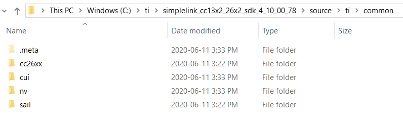

    The directory simplelink_cc13x2_26x2_sdk_4_10_00_78/source/ti/common/cc13xx  is missing.
    I also installed simplelink_cc13x2_26x2_sdk_3_40_00_02 and again ource/ti/common/cc13xx is not present.
    Why are they missing?

    Thank you for replying!!
    If those files do not exist anymore, then all LPSTK-CC1352R BLE5stack examples are broken.
    All of them refer to cc13xx HAL which is not present in the SDK.
    For instance, simply look at following Makefile:
    C:\ti\simplelink_cc13x2_26x2_sdk_4_10_00_78\examples\rtos\CC1352R1_LAUNCHXL\ble5stack\multi_sensor\tirtos\ccs\Makefile:
    util.obj: $(SIMPLELINK_CC13X2_26X2_SDK_INSTALL_DIR)/source/ti/ble5stack/common/cc13xx/util.c ti_drivers_config.h $(CONFIGPKG)/compiler.opt
    	@ echo Building $@
    	@ $(CC) $(CFLAGS) $< --cmd_file=$(CONFIGPKG)/compiler.opt --output_file=$@
    ECCROMCC26XX.obj: $(SIMPLELINK_CC13X2_26X2_SDK_INSTALL_DIR)/source/ti/ble5stack/common/cc13xx/ecc/ECCROMCC26XX.c ti_drivers_config.h $(CONFIGPKG)/compiler.opt
    	@ echo Building $@
    UartLog.obj: $(SIMPLELINK_CC13X2_26X2_SDK_INSTALL_DIR)/source/ti/common/cc13xx/uartlog/UartLog.c ti_drivers_config.h $(CONFIGPKG)/compiler.opt
    	@ echo Building $@
    The following files do not exist at all:
    • $(SIMPLELINK_CC13X2_26X2_SDK_INSTALL_DIR)/source/ti/common/cc13xx/uartlog/UartLog.c
    • $(SIMPLELINK_CC13X2_26X2_SDK_INSTALL_DIR)/source/ti/ble5stack/common/cc13xx/util.c
    • $(SIMPLELINK_CC13X2_26X2_SDK_INSTALL_DIR)/source/ti/common/cc13xx/crc/crc32.c
    • $(SIMPLELINK_CC13X2_26X2_SDK_INSTALL_DIR)/source/ti/common/cc13xx/flash_interface/external/flash_interface_ext_rtos_NVS.c
    • $(SIMPLELINK_CC13X2_26X2_SDK_INSTALL_DIR)/source/ti/ble5stack/profiles/oad/cc13xx/oad.c
    • $(SIMPLELINK_CC13X2_26X2_SDK_INSTALL_DIR)/source/ti/ble5stack/profiles/oad/cc13xx/oad_image_header_app.c
    • $(SIMPLELINK_CC13X2_26X2_SDK_INSTALL_DIR)/source/ti/ble5stack/profiles/oad/cc13xx/oad_util.c
    • $(SIMPLELINK_CC13X2_26X2_SDK_INSTALL_DIR)/source/ti/ble5stack/profiles/dev_info/cc13xx/devinfoservice.c
    All cc13xx directories are missing in simplelink_cc13x2_26x2_sdk_*.
    The same issue occurred at least with both simplelink_cc13x2_26x2_sdk_4_10_00_78  and simplelink_cc13x2_26x2_sdk_3_40_00_02 SDK. I Did not try with older SDK.
    Do you have any suggestions?
    Sincerely

    It's a bit confusing.
    1- Why our Makefile are different?
    2- According to your Makefile, could we really build a BLE CC13X2R1_LAUNCHXL example with CC26xx HAL?
    Sincerely,
  • I see the makefile you are referring to in the SDK directory (C:\ti\simplelink_cc13x2_26x2_sdk_4_10_00_78\examples\rtos\CC1352R1_LAUNCHXL\ble5stack\multi_sensor\tirtos\ccs) but don't believe that is used for the build. When the project is imported into CCS, the .projectspec file in that same directory is used to create the project and its properties. Then CCS auto-generates its own makefile at build time.
    I will forward this thread to the device/SDK experts so they can further clarify and answer your questions about this example.
    Actually, without using CCS, with a basic shell interface, I should be able to run this command:
    cd C:\ti\simplelink_cc13x2_26x2_sdk_4_10_00_78
    make -C .\examples\rtos\CC1352R1_LAUNCHXL\ble5stack\multi_sensor\tirtos\ccs
    If not, you should remove the makefile
    Hum let's consider that the makefile is auto-generated. However:
    • where is the cc13xx HAL?
    C:/ti/simplelink_cc13x2_26x2_sdk_4_10_00_78/source/ti/common/cc26xx/ is present
    C:/ti/simplelink_cc13x2_26x2_sdk_4_10_00_78/source/ti/common/cc13xx/ is NOT present. Why ?
    • Why your Makefile compile the multi_sensor example for the CC1352R MCU using cc26xx HAL?
    Yes please, I am looking forward to hearing from you
    Sincerely,
  • I created a new project by importing the BLE multi-sensor example.
    I am now able to successfully build the source code.
    Lesson learned:
    1. Initial Makefile are incorrect as they wrongly depend on the unexisting cc13xx directories
    2. Both CC26xx and CC13XX chipset are using common/cc26xx/ Hardware Abstraction Layer. It might be "nice" to rename them as:
    • $(SIMPLELINK_CC13X2_26X2_SDK_INSTALL_DIR)/source/ti/ble5stack/common/hal/
    • $(SIMPLELINK_CC13X2_26X2_SDK_INSTALL_DIR)/source/ti/common/hal/
    • $(SIMPLELINK_CC13X2_26X2_SDK_INSTALL_DIR)/source/ti/ble5stack/profiles/oad/hal/
    Thanks for your support
