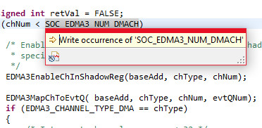

Place the cursor on "EDMA3_CHANNEL_TYPE_DMA" and press F3.  It opens the edma.h file and identifies the marco...  All good.
Place the cursor on "SOC_EDMA3_NUM_DMACH" and press F3.  It does nothing. But this macro is defined in the same header file!
Hover over it, and a popup appears:
(whatever the heck "write occurrence" means...? )
Also, when the cursor is on "SOC_EDMA3_NUM_DMACH" the other ones don't even highlight  And it's in the same source code file.
Our friendly little Ctrl-F search box will find it, but that is limited to open the file in focus. Also Ctrl-H will find it under "file search", but not under "C/C++ search" ??!  But that search box is modal, so that's really annoying (the output isn't but the input is - so forget copy/paste while it's open).
It is annoying to have to use the Ctrl-H or even Notepad++  (but I do all the time, just like Gerald Belanger mentions) and have to filter through all teh hits to figure out which is the definition, over all the other uses.
