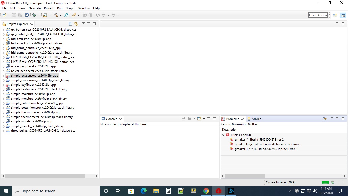

I have this CCS project simple_keyfinder that is building at my laptop. To test portability, I imported it before months ago at my desktop PC and build without errors. Today I imported it another CCS workspace at the same desktop PC and now I am getting this build-1125455679 error. Here is the console message below. how do I solve this problem?

  • Do any of the suggestions in CCS gmake errors help?
    And is the error only occurring on only one project/workspace on the desktop PC, or multiple?
    Not sure if something has changed on the desktop PC to cause the build failure, e.g. another gmake in the path.

    As I have mentioned the CCS project builds at my laptop CCSv9.20 workspace. To test portability I import the CCS projects to my desktop PC CCSv9.20 workspace, it builds without errors. That was months ago.
    Now I rebuild all the CCS projects at desktop PC again, and now I get the build errors.

  • Hi Markel,
    This is really odd, especially that the project built fine several months ago but not anymore.
    As Chester suggested, my first recommendations also would be to look at the gmake link and try importing/building in a new workspace. Another suggestion would be to compare the versions of XDCtools, compiler, etc used in the build for the laptop vs desktop versions and ensure they are the same.

    Yes, its odd. I already created a new workspace at the Desktop PC and I still get the errors. However, at Laptop PC there is no problem even at new workspace. Anyway, I will look into other options to resolve this. Maybe I will re-install CCSv9.2.

    I have no luck with this with re-installing CCSv9.2. The gmake link does not help either. I will just try to solve this problem at a later date. I will just mark this post as resolved for now
