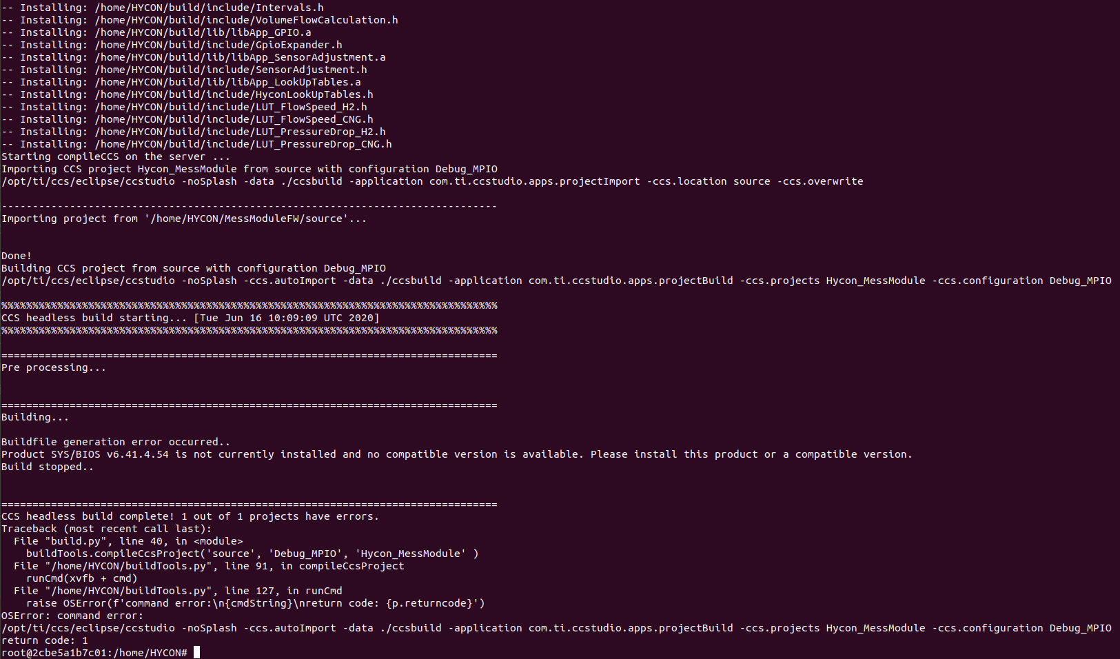

  • Customer wants to create an automated build. For that it needs to run in a Docker ecosystem
  • CodeComposer is already installed in Docker
  • They are facing problems with installation of SysBios -> they are getting the error code "SysBios not installed"
  • They installed SysBios under /opt/ti.
  • In additiona they tried to install in /opt/ti/ccs/toos/compiler but it is not working
  • Also is there a possibility to implement tools headless (without GUI)?
  • See attached file with the error
  • By the way: there is no ERROR if they use CCS locally (with GUI). There they also simply can add new tools. Headless doesn`t work.
