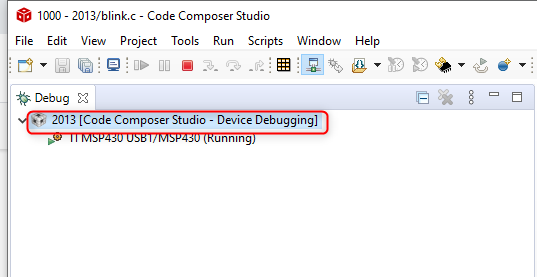

  • Thanks. In the Debug view, please select the node called "TI MSP430 USB1/MSP430". Once you select that, you should see the "suspend" button become available, allowing you to halt the target. Since the target is already running, the run and step buttons will still be greyed out. But you will be able to press the "suspend" button to halt the target.

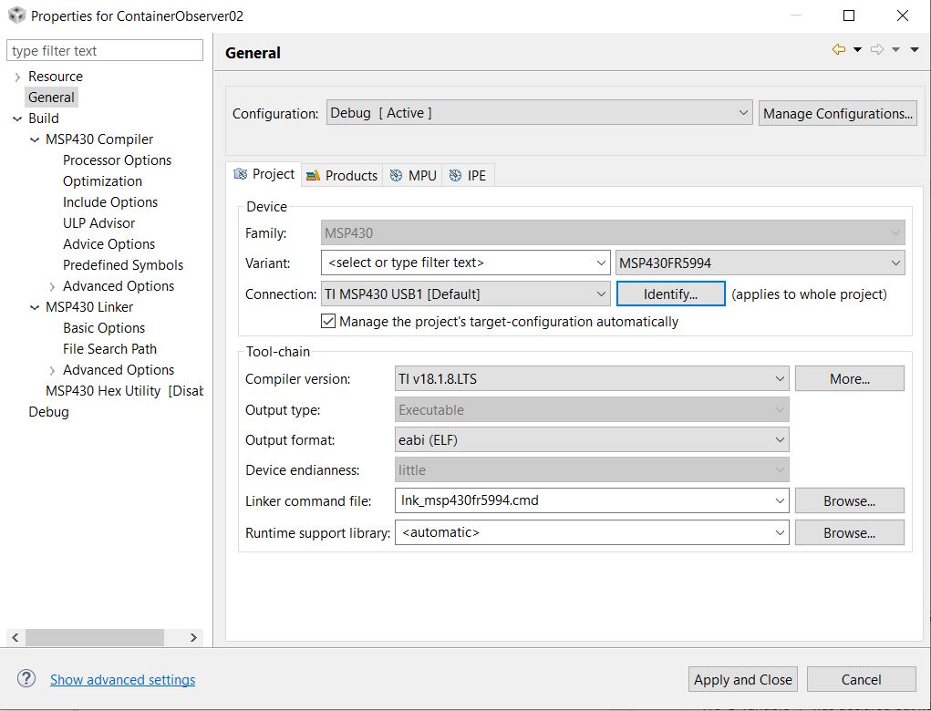

    I am sending a screenshot of the General Properties page. Is it possible that the debugger can never run if I have chosen the wrong connection to the device?
    I have the problem that the debugger is usable with 99% of the code. The program has more than thousand lines. If I set the comment characters /* */ in the following code segment, I can use the debugger. But I have to debug the complete program in real time. Why I don't get error messages?

    This are my settings of the General page. Is this what you mean?
  • Hardy Zissel said:
    sorry, I don't understand what I have to do.
    In the Debug view, you have the top node selected like so:
    This is not a proper debug context, which is why all the target execution buttons are greyed out.
    If you select the context below it like so:
    Note the suspend button is now available for you to halt the running target to see where the program counter is.
    In your screenshot, the debugger is connected to your target and showing target execution. If the code is not running as expected, it could be that there was some issue with your application or target. Suspend the target and see where the program is stuck.

    The key thing regarding the suspend button being "active" is the proper debug context. Everything else will not have an impact regarding that.
