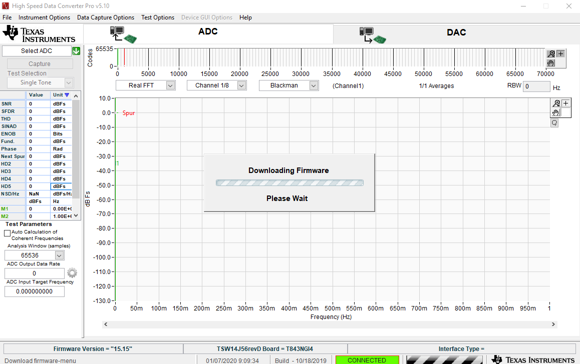

    Calling the API that selects the ADC device, causes the system to be stack in firmware download, python code:
    print "Selecting ADC Device : " + Devicename
    Err_Status = HSDC_Pro.Select_ADC_Device(Devicename,120000)
    print "Error Status = " + str(Err_Status)
    Yaron

    2.       With regards to the issue faced when using the “Select_ADC_Device” automation function, try to download any Firmware manually from the menu option Instrument Options>>Download Firmware and see if that causes the same issue, if not kindly share the string value of “Devicename” variable used in the “Select_ADC_Device” automation function and share us the INI file with the same name as that of string value of “Devicename” variable, which will be present at the following location if you are using the “TSW14J56RevD” board:

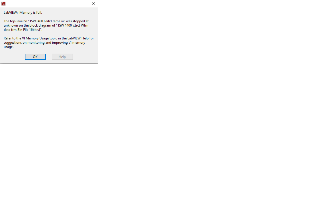

    1. I have tested the “Get_Capture_Data_16bits” with larger samples size, I got an out of memory message although my system has sufficient memory from labview (I am trying to get 512M elements).
    I will attach the messages.
     2. Regarding the issue, I have tried to download the firmware manually. The system was stuck on download firmware, from this point it was impossible to select the ADC manually, each try ended with the system being stack. Only restarting the computer enabled me to select again the ADC manually.
    the ADC I am selecting manual and Automatically is: "ADS54J40_LMF_8224"

    HSDC Pro Software is running on LabVIEW 2014 32Bit Run Time Engine which can access only limited amount of virtual memory. When executing “Get_Capture_Data_16bits” automation function with larger samples size, the memory of the LabVIEW 2014 32Bit Run Time Engine gets overloaded and this causes the LabVIEW Memory Full Error. Instead, try accessing the channel wise binary files that are generated in the folder C:\Users\Public\Documents\Texas Instruments\High Speed Data Converter Pro\HSDCPro Data after completing the “Capture” process to avoid this memory full error.
