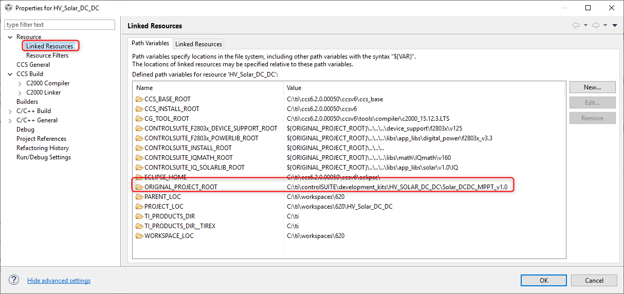

I did "Import CCS HV_Solar_DC_DC Projects".
Daniel
  • Hi Daniel,
    The issue is that when the project is imported, there are issues with the linked resource path variables that the project relies on. The easiest way to resolve this is to tweak the "ORIGINAL_PROJECT_ROOT" variable to the location that the other variables think it is set to.
    Open the project properties and modify it to the location shown below. This is resolve the build errors:
