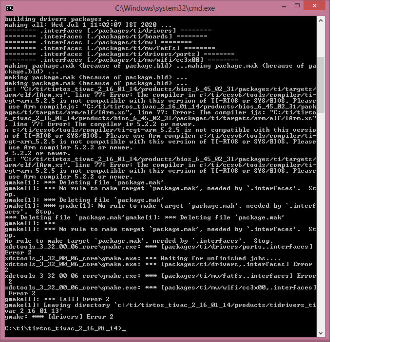

but Fatfs to support LFN I got following error while compiling tiRtos.mak
I made following changes in
1.In <tirtos install dir>/products/tidrivers_#_##_##_##/packages/ti/mw/fatfs/, edit ffconf.h
#define _USE_LFN 3//0
#define _CODE_PAGE 437//932
2. While rebuilding SYS/BIOS I got following error
Please guide us how to make fatfs to support LFN
