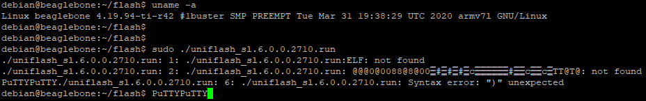

Hello Uniflash team,
My customer is desining a new board with an AM3354 device + CC2562. They want to be able to update the CC2652 through BSL in the field. i understand Uniflash is the best "ready" solution for this. However, when he tries to install uniflash on a BBB running Debian he's got the following error
I have also tried in my setup and found a very similar problem.
When trying the same .run file in a Ubuntu machine it works great.
Are you guys aware of any limitation regarding installing Uniflash in a BBB Debian system? Please let me know your comments.
