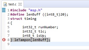

If I use:
const int8_t  lenBuffer=20;
struct timing
int32_t runNumber;
int32_t tic;
int8_t isUp;
} buffer[ lenBuffer ];
it compiles with a warning about being not standard.  If I try with a #define, it does not even compile.
What is the preferred way to do it, in CCS?  I mean, I prefer to use a defined constant, like lenTampon, instead of a magical constant like 20 here and there, in the C code.
    This is legal in C++.  In C, it is not legal.  But the TI compiler accepts it anyway, and issues the warning you mention.
    I cannot reproduce this result.  For the source file which has this problem code, please follow the directions in the article How to Submit a Compiler Test Case.
    Thanks and regards,
    -George
  • Case solved. I included the file that I was using and, interestingly, retyping it to resubmit it, but without the ending semi-colon at line 2, as it is the right way to do it, there is no error anymore. Just a case of a bad oversight from my part.
