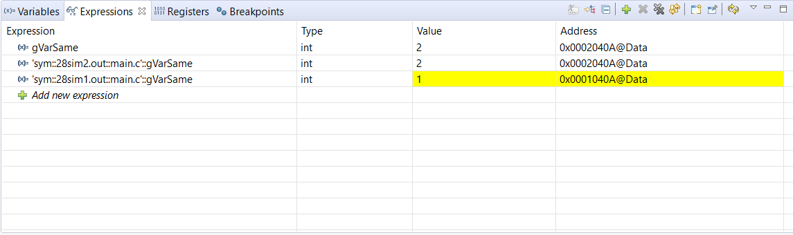

  • I checked with the engineering team and there is a way to specify the symbol file in addition to the variable name. The syntax is:
    'sym::a.out::a.c'::v   - look for a file static variable v defined in source file a.c from a symbol file matching name a.out
    In the example below, I have two projects, both which define a 'gVarSame" global variable in 'main.c'. Specifying just 'gVarSame' displays the value for the second project. If I use the syntax specified above, I can specify the symbol file, source file, and variable name so that I can see the value for both gVarSame variables.
    ki
  • Hi Ki,
    I discover that the symbols for all of the projects need to be added first.  After that, this worked great.  I really appreciate the extra effort.
