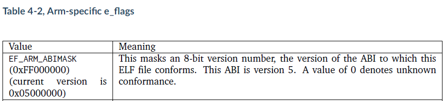

  • I can shed some light on ...
    Edward Blair said:
    Step 3 - Edit the .out file to have the correct ELF e_flags value
    Open up the BinaryFile.out file in a binary (hex) editor. Change the value of byte 0x27 from 00 to 05.
    This will allow the ccs linker to accept the ELF file, otherwise it generates an error.
    This step is the only one that is not really documented anywhere. The number 5 came from a ccs error message.
    All recent ARM compilers conform to the ARM Extended Application Binary Interface standard.  That page contains a collection of about 20 documents.  Focus on the one titled ELF for the ARM Architecture.  Obtain the related PDF file and search it for e_flags.  It shows the following ...
