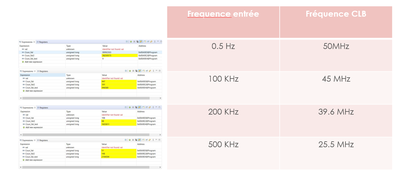

  • i wanna control the clock of the CLB in general and particulary the clock driving its counter ...
    my big issue is that inspecting the values of the counter (in an application that detects the period of different PWM signals) i found that the frequency of the counter is not the same for all the input PWM signals. Its frequency changes inversly propotinal with the rate of the input signal.
  • How did you change the freq of the CLB?
  • I didn't change the frequency of the CLB. I'm using its counter to return the period of different PWMinput signals.
    When I change the frequency of the input signals, the readings of the counter indicate that the frequency of the CLB is changing as well.

  • PWM signals generated by an external source on a GPIO pin... Using the CLB's counter and FSM I can detect all the falling edges of these signals and then with an ISR I read the value of the counter register C0 at every falling edge  (which reprensents in my case the period of the input signals) and then reset the counter.
    The problem here is that the values of the counter are indicating that its frequency  is changing depending on the frequency of the input signals .. as indicating the screenshot above.

  • Thank you the problem has  been resolved ....
    I discovered after a while that the values of the counter -indicating that the frequency of the block is changing- contained actually  a fixed error of 50 points ... This error varies depending on the length of the ISR which generates the signal that does the reset of  the counter ..
    So the transition between the CLB and the processor takes "apperently" long time.
