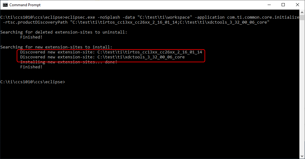

  • I did come across that in my research and tried it, but it didn't do anything for me. Is the expected result from using that command that those products will be displayed under the Discovered products when you go to Windows > Preferences and navigate to Code Composer Studio > Products?
    When I executed that command I got the following output:
    PS C:\src\MyProject> eclipsec.exe -noSplash -data "C:\Users\Me\workspace_v10" -application com.ti.common.core.initialize -rtsc.productDiscoveryPath "C:\ti\tirtos_tivac_2_16_01_14;C:\ti\xdctools_3_32_00_06_core"
    Yes.
    Searching for new extension-sites to install:
    Finished!
    Assuming that the products were not discovered before, I would expect some additional messages about extension site for each product being discovered like in my example below:
    Those messages would not appear if they are already discovered by CCS

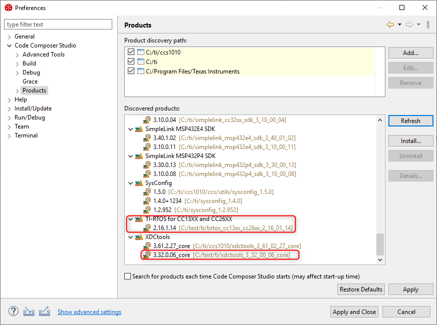

    When I manually opened the CCS GUI and look at the Windows > Preferences > Code Composer Studio > Products I do not see those two paths added under Product discovery path.
    They would not show up in the discovery search path but should appear in the discovered products list like so:
    can you try pressing the "Refresh" button to auto search? When you get the list to install, press the "Not Now" button to decline installing anything. However, this action may refresh the discovered products list. See if the missing products appear. I don't think this will work since your build fails but it is worth a try to rule it out.

  • Oh good lord, thank you for including that screenshot of your command prompt! Without it I wouldn't have tried executing my script in Command Prompt, because I've been using PowerShell to execute everything. I get the same result as you when I execute the command in a Command Prompt.
    Now, do you happen to know why that is? It's not important necessarily for resolving this issue, but it would be nice to know why eclipsec appears to silently fail when executing via PowerShell and now Command Prompt.

    I may have prematurely clicked the resolve button. I still needed to manually open CCS GUI and click the Refresh in Windows > Preferences > Code Composer Studio > Products for my version of XDCtools (3.32.00.06) to be recognized. Without doing that it appeared to keep the default XDCtools (3.61.2.27) and the building failed.
    Does that only happen with the XDCtools package? Or do you have the same issue with TI-RTOS?
  • As far as I can tell only the XDCtools package, because before I click the Refresh button the TI-RTOS for TivaC v2.16.1.14 shows up and the XDCtools only shows 3.61.2.27_core. After I click the Refresh button the XDCtools 3.32.0.06_core shows up. I can then close out of the CCS GUI and run my script and it succeeds.
  • Ok, I think there is some issue with XDCtools. I see the same issue with the package. Not sure it is that specific version or all XDCtools. I'll have to investigate further...
  • I tried a few version of XDCtools. It looks like there is some limitation there. I'll need to escalate to engineering
