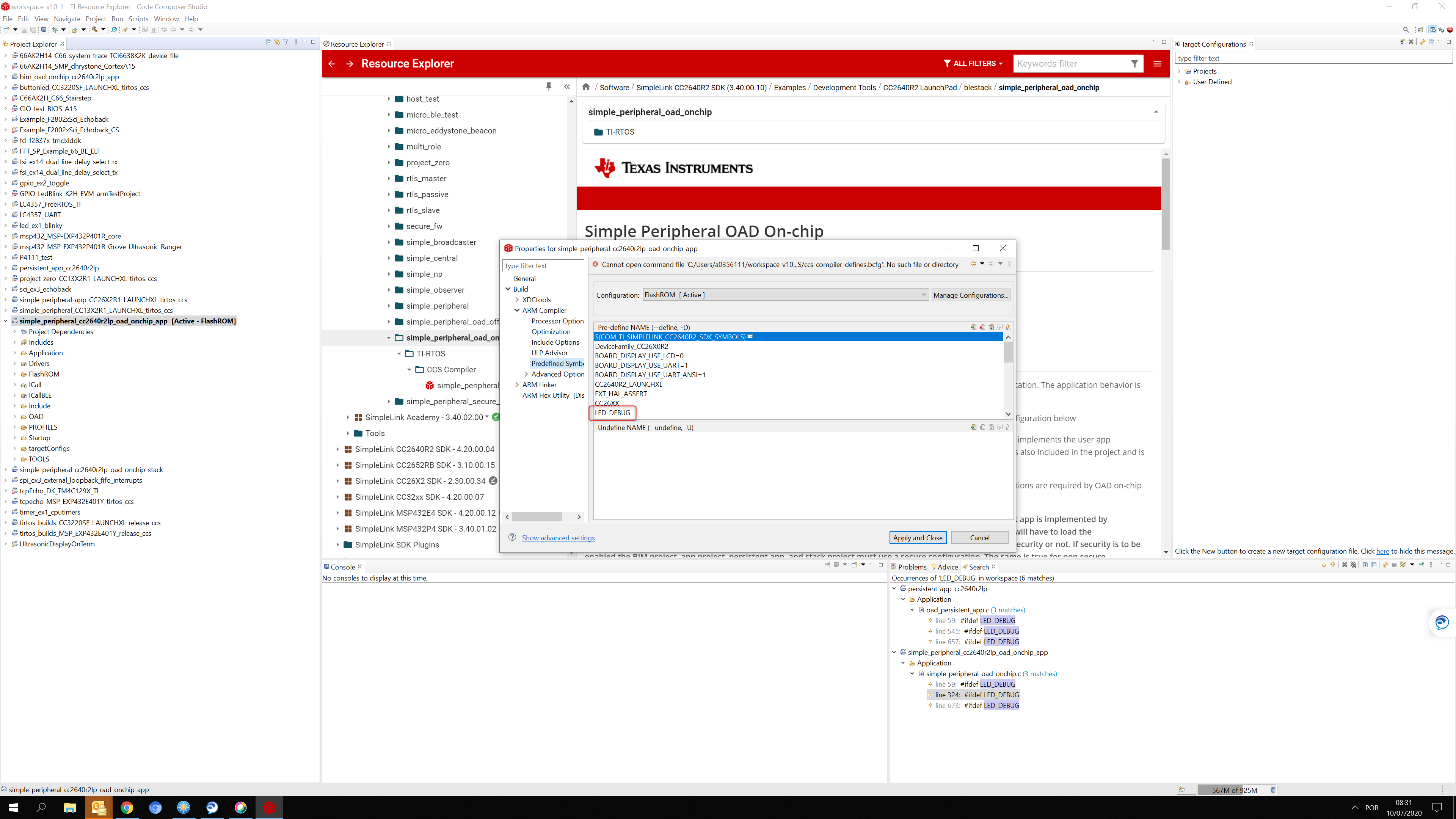

I import a offchip oad project from simplelink_cc13x2_26x2_sdk_4_20_00_35,but don't know how to sisable LED_DEBUG.
    It should be defined in the project properties.
    If your project is different, do a search (Ctrl-H or the small flashlight icon on the toolbar) and search for the term LED_DEBUG (the results are shown in the bottom right of the screenshot above)
    Hope this helps,
