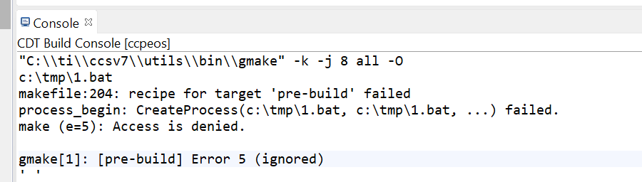

Trying to run a pre-build batch file, as part of a project build.  Unfortunately, it keeps err'ing out, as shown below.  I've reduce the problem replication to a very simple batch file, that does a simple "dir" command, for the time-being, until finding out what is causing the issue.  I'm using CCS 7.3.0.  Please advise.

    Then you should see something like:
    That "make (e=5)" error is usually caused by some permissions issue. Check the tmp directory or the 1.bat file and check it has the proper execute permissions

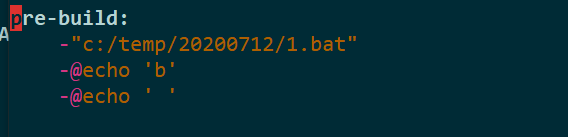

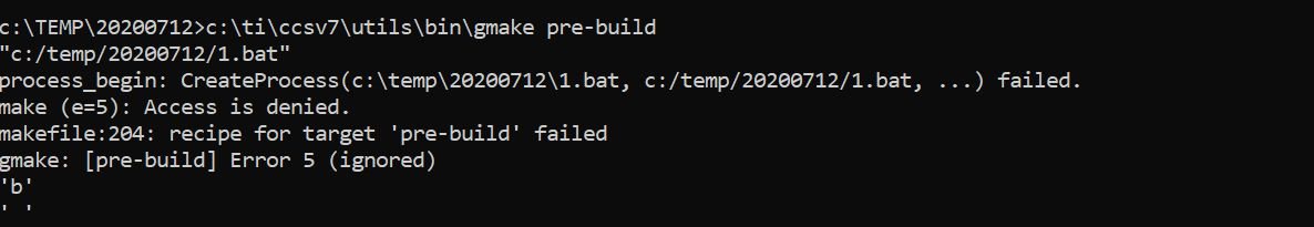

    Thanks for the reply.  To try and totally disconnect it from any GIT-related issue, I just created a simple bat file, 1.bat, and put it in a c:\temp directory, and tried to run it via gmake.  And it failed again, as shown below.  The gmake version we're using for our project is from ccsv7, so that is put directly in the calling path.
    Here is the associated makefile line for "pre-build"
    1.bat has a simple "dir" command in it.
    As you can see, the gmake is still having issues trying to run this batch file.  I have several gmake versions on my computer, including one from a later version of CCS, one in XDCtools directories.  But as shown above, I've specifically called the CCSV7 version, so there shouldn't be any incompatibility involved, right?

  • Thanks Ki.  Even if I run the make command from a command window, explicitly spelling out the gmake path (c:\ti\ccsv7\utils\bin\gmake), I get the same error.  I don't think it is path related, although I did put that path at the front of my system PATH environmental variable (with no change in error).
    It is something about the TI gmake and Cygwin GIT interaction causing an issue ... at least that is still the latest suspicion.
