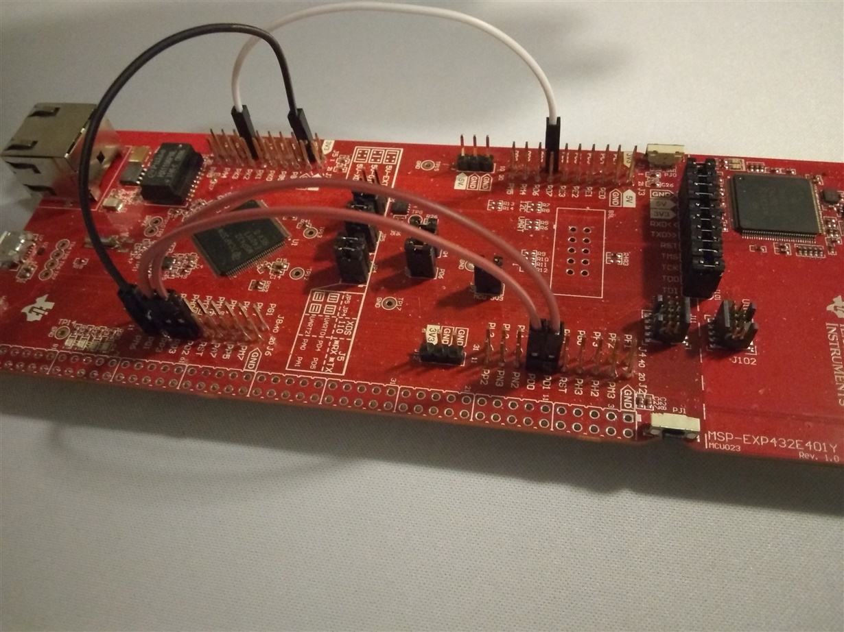

Here is a picture of the physical setup I have on my board

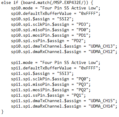

I have attached these wires in accordance with the pinout descriptions offered in the spiloopback.sysconfig file (shown below).

  1. I have opened the sysconfig file in notepad and setup my board accordingly (see screenshots above)

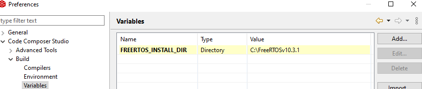

  3. I have declared the CCS build variable FREERTOS_INSTALL_DIR as a directory and set it to my install directory.

It compiles without any errors or warnings. When I run the program, the LEDs blink as they are supposed to and the program runs to completion as though nothing is wrong but my slaveRxBuffer and masterRxBuffer remain empty throughout the program, never being changed from their initial state. The program is under the impression that the transfer happened successfully.
Is there anything else that I should be doing prior running the example?
Have I done anything wrong so far in attempting to run it?
