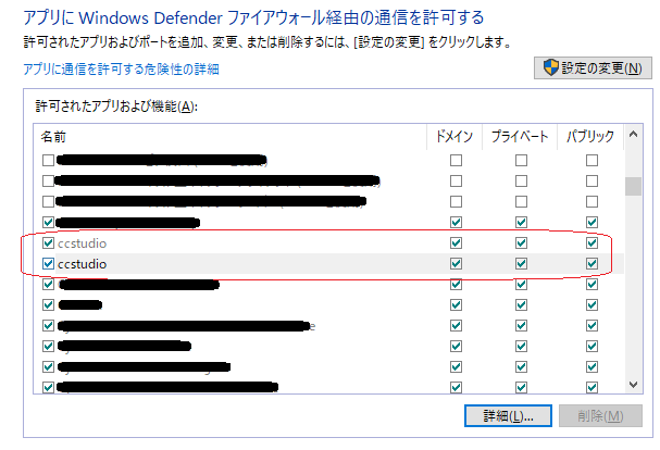

My customer has problems with the CCSv10(10.1.0.00010) update feature.
They want to try to set up permissions for the Windows Firewall.
The figure below shows the properties of Windows Defendar after installing CCSv8.
(For some reason, it can see two "ccstudio" .)
When CCSv10 is installed, "ccstudio" does not appear in Windows Defender. How is the firewall individually configured for CCSv10?
    The list would show all CCS versions that was allowed access on the PC. If the customer checks the properties of those two instances, they may point to two different versions. Note that they may even reference versions that do not exist on the PC anymore

    Access to the CCS is not a problem. There is no access to update functions and App Center.
    H.U
    I see. Does Resource Explorer work? Or the Eclipse Marketplace?
    Please also check the Proxy Settings in CCS.
