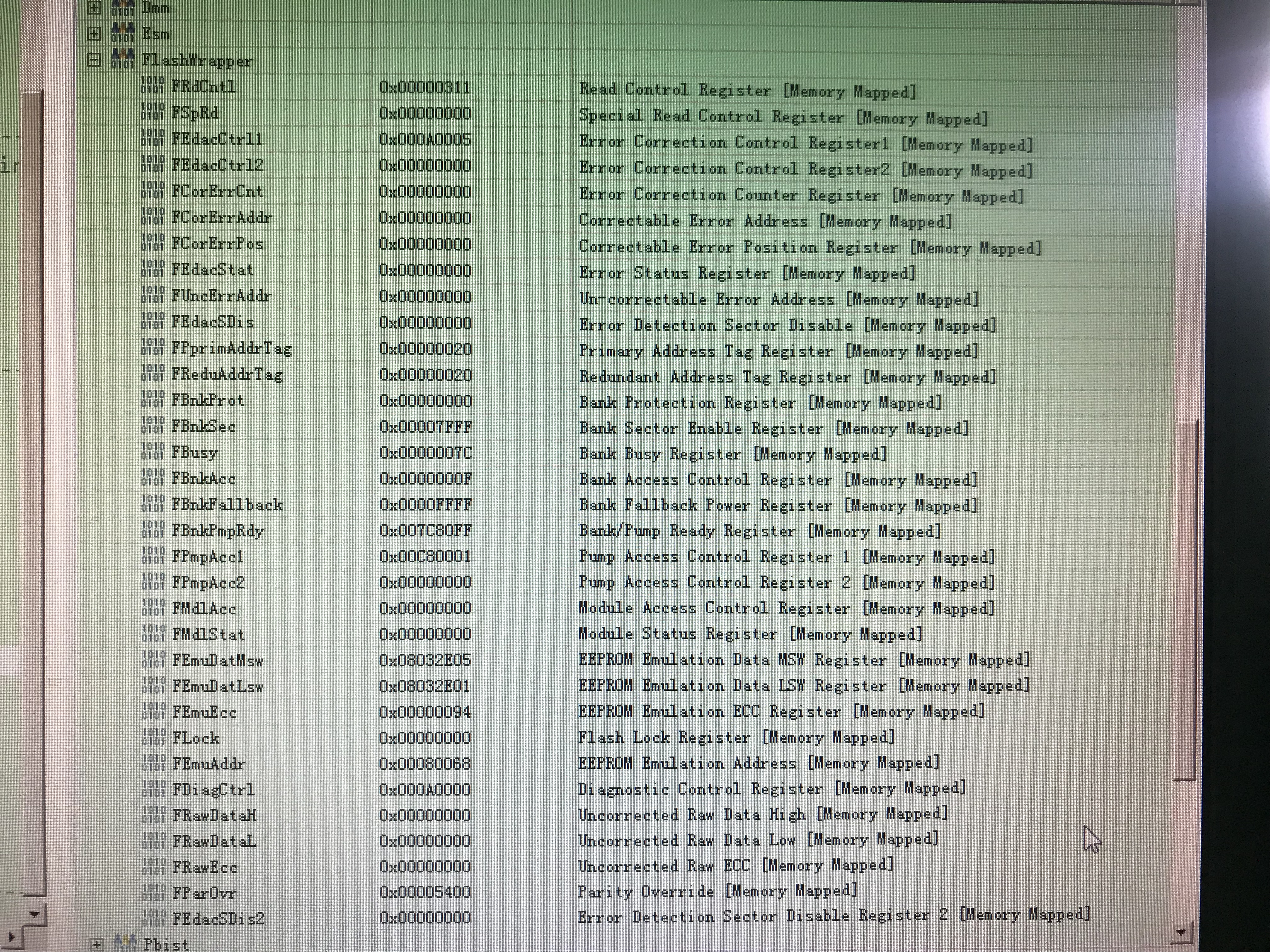

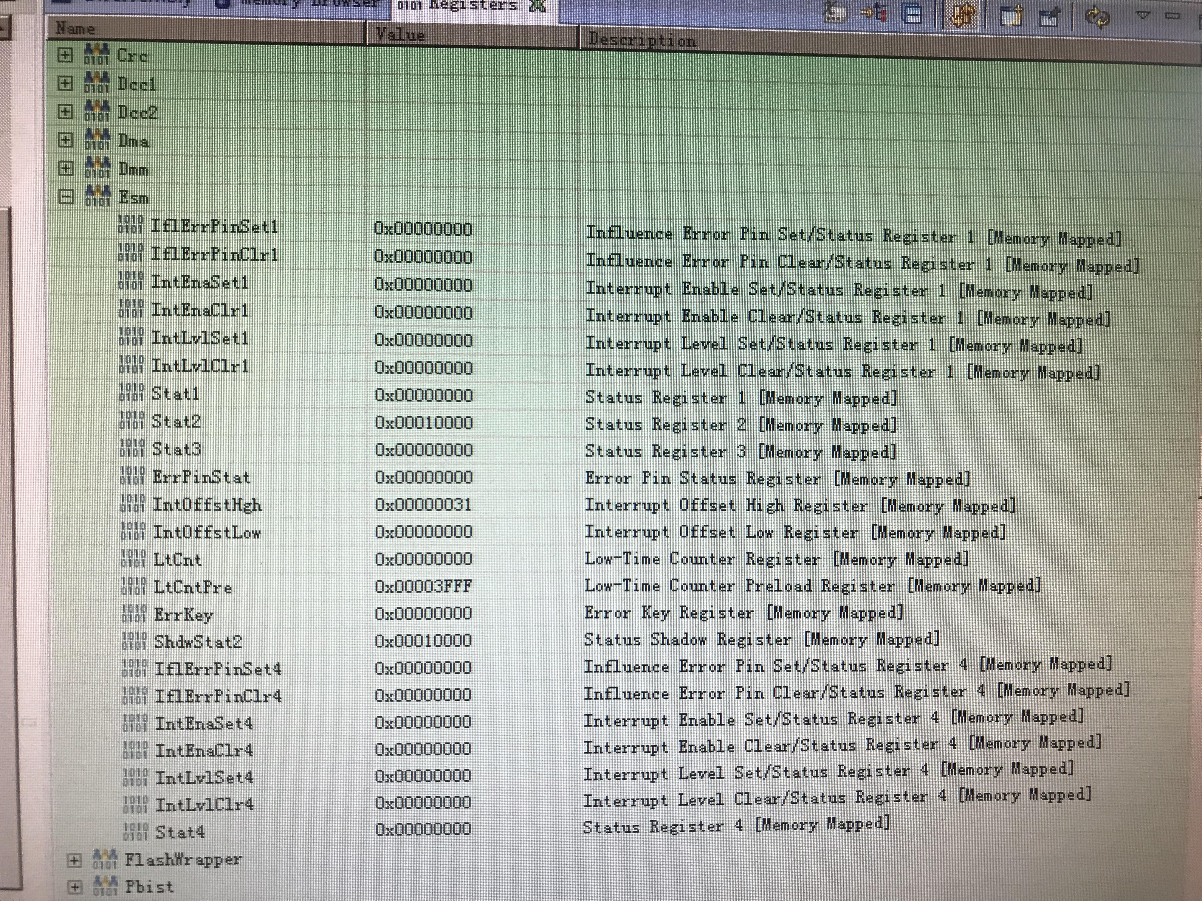

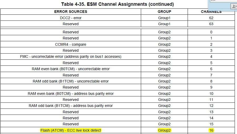

  • HI
    The following two figures show the register contents when ECC error occurs in simulation debugging
    Now the error of ECC live lock detect appears. I don't know how this error occurred?
    Can ECC be disabled?
    Looking forward to your reply!!!
    Please refer to the sample code in TI bootloader: bl_flash.c (attached). This file has functions to erase/program flash using F021 flash APIs.
    The ECC checking should be disabled if you call flash blank check after erase operation. To disable the flash ECC check, please use the function defined in sys_core.asm: _coreDisableFlashEcc_()
