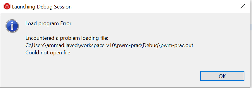

  • Hi John,
    After the proper selection of debug probe, the following error is being shown. This time I am using examples from C2000ware.
  • Even after adding header files, the error is shown that 'cannot open source file  f2802x_examples.h'
  • Adding the header file to your project will not resolve that build error.  This is because the #include has a path as part of it.  i.e. the #include statement ithe way it is will look at each directory specified in your include search path and add /common/include/f2802x_examples.h to it.  This file is in C:/ti/c2000/C2000Ware_3_02_00_00_Software/device_support/f2802x/common/include
    Thus C:/ti/c2000/C2000Ware_3_02_00_00_Software/device_support/f2802x would need to be in your search path for it to be found

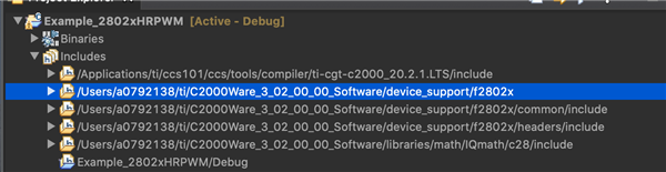

    When I import that project from Resource Explorer I see the same #include statements:
    However there are a lot more files in my project:
    I also see more include paths listed in my project.  The second one is the one that resolves the location of the file
    Here is where they are specified in my project:
    Instead of trying to fix that up why not just import the project from Resource Explorer?  Building will just work and the only thing you will have to do is specify your debug connection.
