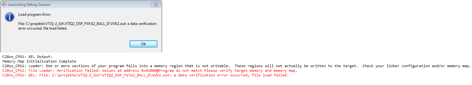

I am not sure, that former questions and answers covers my problem with loading a programm into the FLASH of TMS320F28379D (first time BGA variant).
I got this: see attachment
I read the e2e threads and tried with new CCSv9.3.0. Is it correct, that Blackhawk debugger USB-510-L is not longer supported?
Is there a possibility to go on with CCSv6.2.0?
br Ralf
  • Ralf,
    The last version of CCS to support XDS510 class debug probes was 8.3.1.
    In reading that other thread it looks like the silkscreen on the device will indicate if it is impacted.  If so you would need to update CCS to at least 7.4, 8.3.1 would be my recommendation as it is the newest version that still has support for XDS-510.
