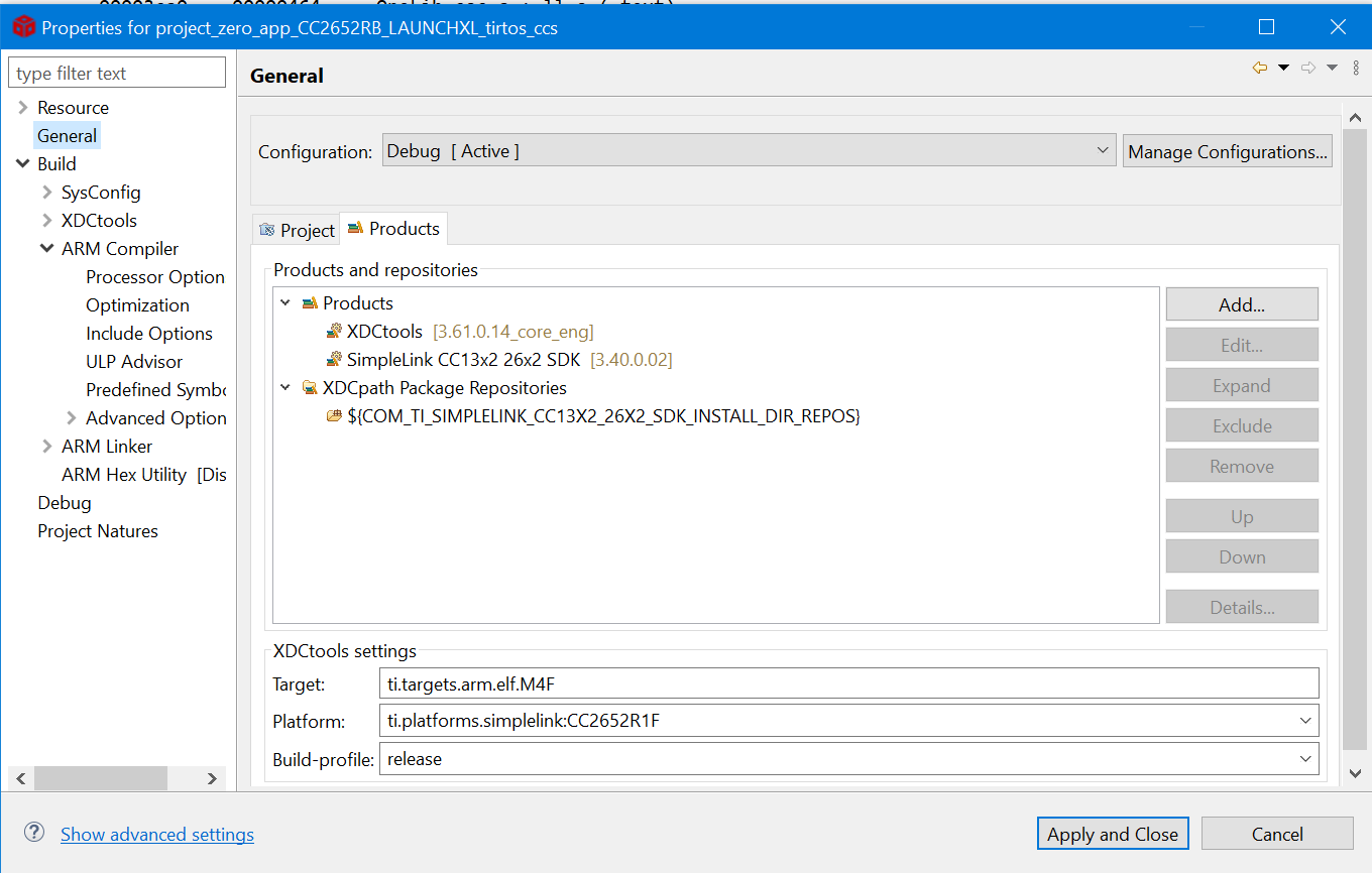

  • Hi Baskar,
    Can you show a picture of Project Properties->General->Product for both the CCS v7 and CCS v10 setup you have? The window will look slightly different between the two CCS versions. Here is an example of the CCS v10 project.
    I'm wanting to see what versions you are using in both setups to give better guidance. Note: depending what you have installed on CCS v7, you might have to increase the size of the window to get all the products shown. I want to see the ones with a checkmark.
    Todd

  • Baskar,
    In the CCS v7 setup, you were using
    • TI-RTOS for CC13xx and CC26xx v2.20.00.06
    • XDCtools v3.32.00.06.
    This worked and is fine setup.
    In the CCS v10 setup, you are using
    • SimpleLink CC13x0 SDK v2.20.00.38
    This is not a valid setup.
    The SimpleLink SDKs replaced the "TI-RTOS for <device>" products. Please remove the SimpleLink SDK and try to build again.
    Note: while similar, SimpleLink CC13x0 SDK is not backward compatible with the TI-RTOS for CC13xx and CC26xx SDK.

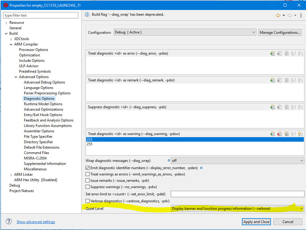

  • Hi Baskar,
    Nothing is jumping out here. Can you enable the verbose mode for the XDCtools build in the Project Properties. Then rebuilld and attach the build output. Please copy/paste it into a file and attach that file.
    Todd
  • Hi Todd,
    Please find the log.

  • It looks fine. Can you try enabling the verbose mode for the compile also (sorry, I should have ask for this along with the XDC verbose request)?
    Again change the setting and rebuild. Please attach the build log as a file instead of copy/paste to keep the thread short.
