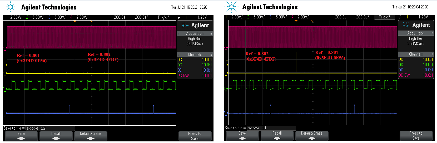

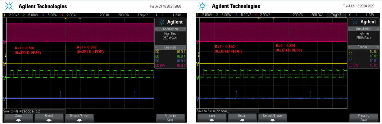

  2. I was able to observe the value of CLLLC_periodSlewed_pu between the two ISR calls and noticed only the 16 LSB were updating (see first set of scopeshots below).

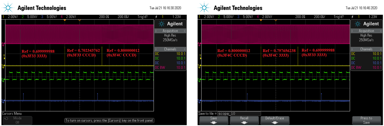

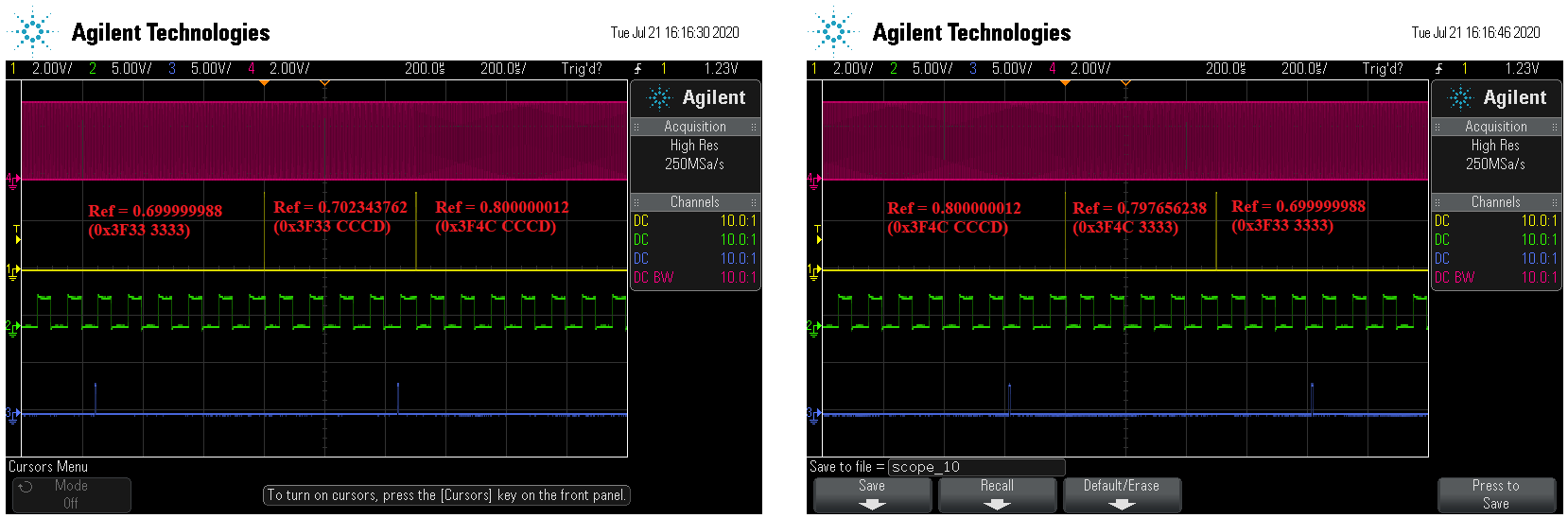

  3. Changing CLLLC_pwmPeriodRef_pu from the watch window by a small enough step that the 16 MSB don’t change always results in a single ISR1 call. (see second set of scopeshots below)
    1. E.g. CLLLC_pwmPeriodRef_pu = 0.801 <-> CLLLC_pwmPeriodRef_pu = 0.802 (0x3F4D0E56 <-> 0x3F4D4FDF)
Here are a couple scopeshots below to help illustrate my point. For debugging purposes, at the beginning of each ISR I assert a GPIO, at the end of the ISR I clear that GPIO.
(Yellow – ISR1, Green – ISR 2, Blue – ISR3, Red – PWM1A)
