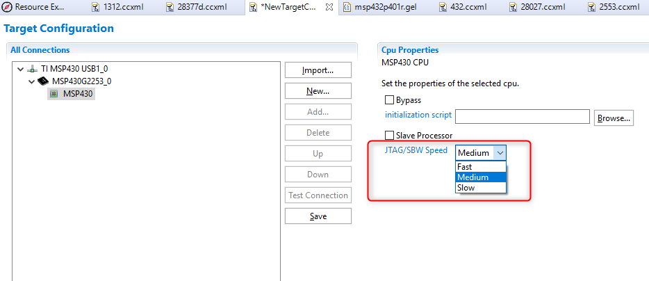

In the context of MSP430G22553, with programming via SBW, where is the clock setting (xml) for slowing the programming clock?  I haven't found one yet.
A slower clock may not be needed, but the jig's original SBW cable was poorly implemented and twisting the cables together improved things.  Later, the CM then changed the cable to shielded (not sure how well implemented) and detection appears to be broken most or all of the time.
    The TCLK comment in the other post would apply to our XDS debug probes and not the MSP-FET.
    Ok. Is there is no way to decrease SBW clock?  If it helps any, I failed to mention in original post that we are using Launch Pad MSP-EXP430G2 v1.5 with UniFlash.
    You can try playing with the below setting in the ccxml file:

  • Hello Ki,
    Thank you for the speed tip.  I had noticed this in CCS but was not sure if it mattered or how to implement it.  It appears to default to Medium, so I will try Slow.

  • ello Ki,
    1. There is strong evidence that the production jig has some poor pogo pins, causing intermittent connection to our PCBAs. IOW, hardware issue.
