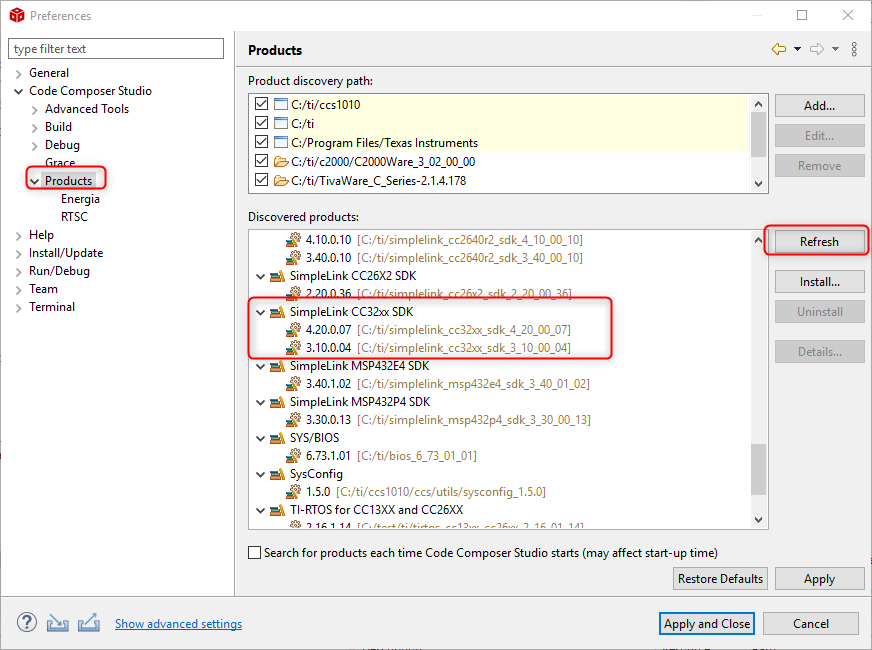

Product com.ti.SIMPLELINK_CC32XX_SDK v3.30.1.02 is not currently installed and no compatible version is available. Please install this product or a compatible version. tirtos_builds_CC3220SF_LAUNCHXL_release_ccs tirtos_builds_CC3220SF_LAUNCHXL_release_ccs Problem
facing this issue after reinstalling ver 10.1 of ccs

    Can you confirm that the SDK was discovered by CCS?
    Please check the 'Discovered Products' list and look for the SDK. If it is not there, make sure that the path to it is in the 'Product Discovery Path' and then press the 'Refresh' button to have CCS rescan for products to discover.

    After refreshing the SDK was detected and project was successfully built.
