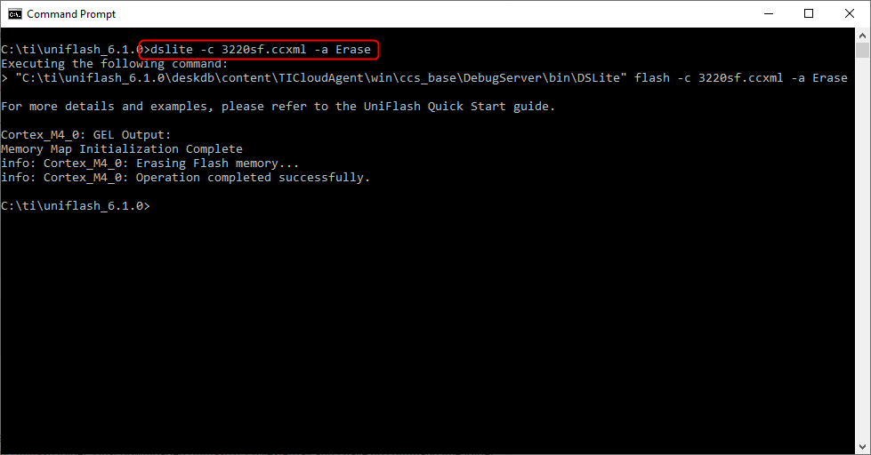

  • You can also try using the UniFlash CLI:
    https://e2e.ti.com/support/tools/ccs/f/81/t/855218

  • Hi Charles,
    It should be in the root UniFlash directory. Note that the FAQ I referenced mentions a *.sh file, which applies for Linux. On Windows, it would dslite.bat.
    You can browse to the UniFlash root folder from a DOS command window and run the below command:
    Just replace '3220sf.ccxml' with the name of your ccxml file. If your ccxml is not in the same directory as dslite.bat, you will need to specify the full path.
    ki

  • See the last sentence in my previous post:
    3220sf.ccxml is the name of the ccxml I created for my cc3220sf launchpad. I manually copied it into the uniflash directory.
