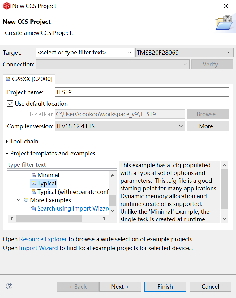

I meet a problem when I creat a sysbios project in TMS320F28069 .The CCS version is 9.3.0,and the sysbios version is 6_82_01_19.Creating project process and error are shown below:

Can you help me solve it?
