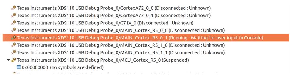

I'm using CCS to debug my code to J721E_EVM target. When I click on Resume(F8) I see the following in Debug tab:
In my code, there is no function that waits for an input.
I go to Console and type two random numbers, then it turns to "Running".
Do you have an explanation about this input?

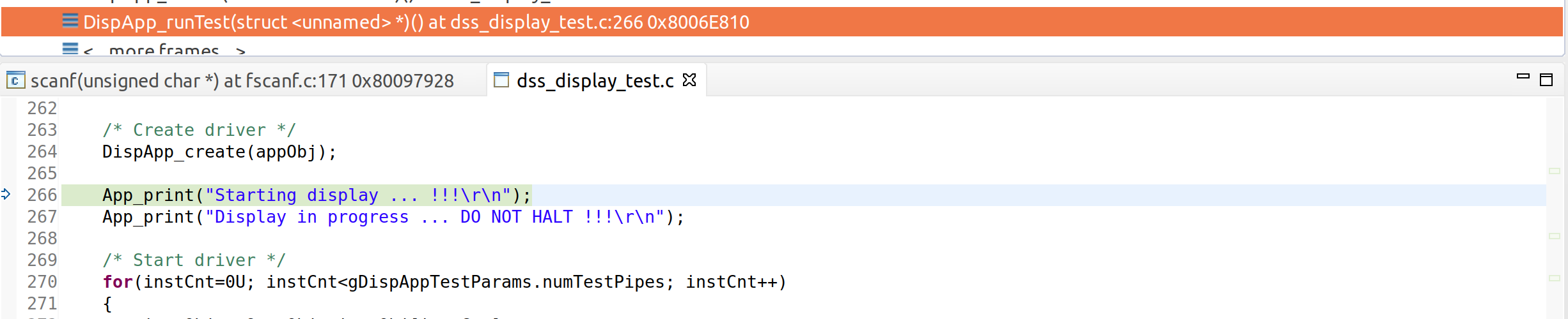

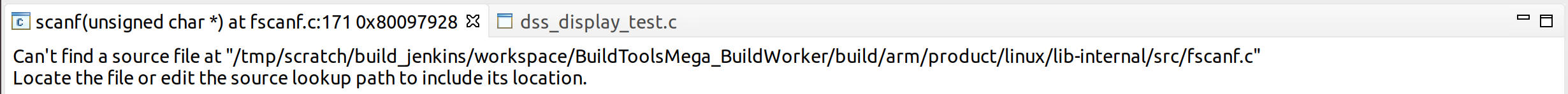

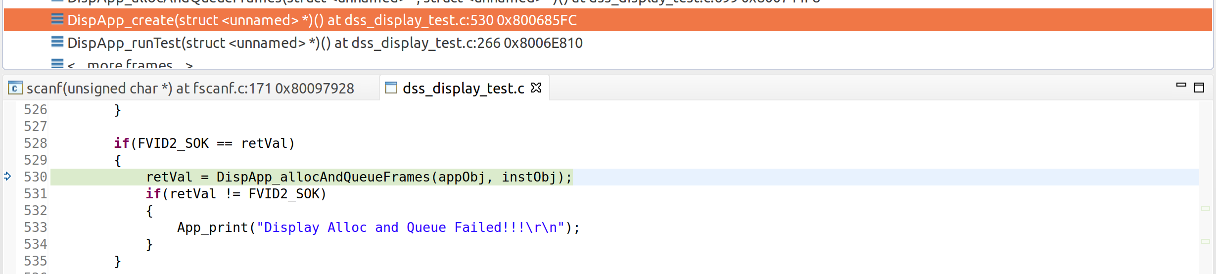

  • Ki,
    When it shows "Running - waiting for user input,,," and I click on Suspend, I got this:

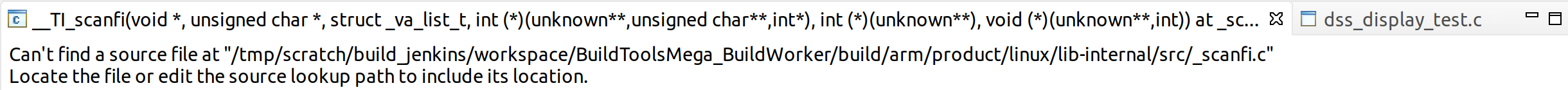

  • In your call stack, you can see that scanf was called. Looks like it is waiting for input from the serial terminal.
