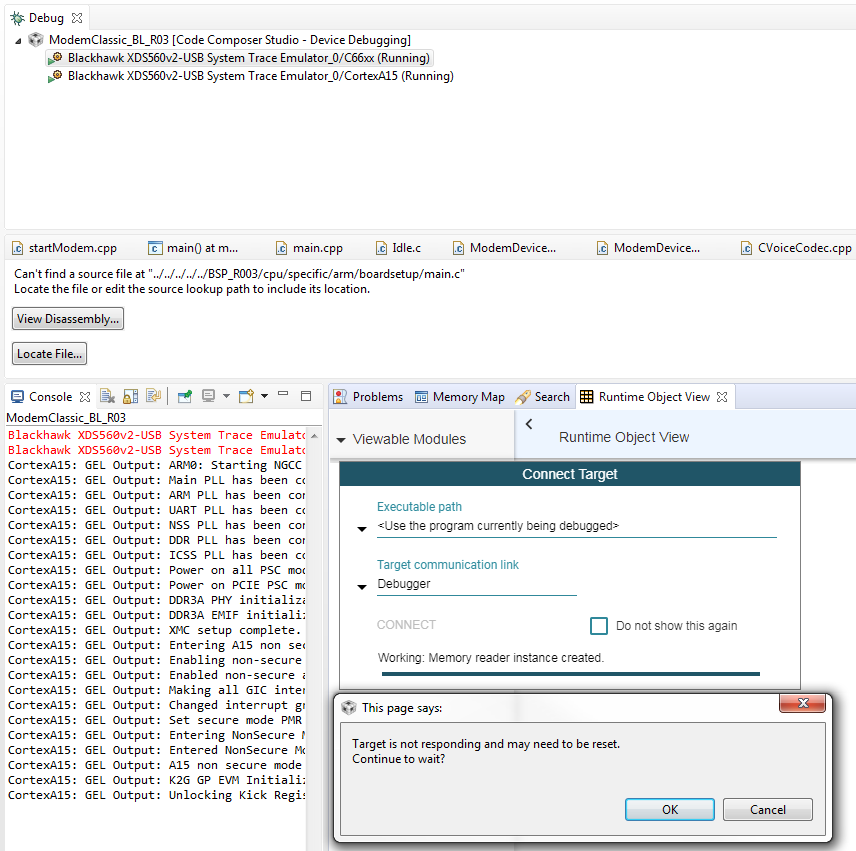

    However, I have not yet been able to get ROV to work with my code.   When I tried this, while I was successfully connected to my target and the images loaded and running, I was unable to successful connect with ROV.  I perused the forum for ROV not connect and found the following thread
    https://e2e.ti.com/support/processors/f/791/t/903050?tisearch=e2e-quicksearch&keymatch=ROV%20not%20connect
    The picture in this thread that shows the message Target Not Responding and May Need to be Reset is what I am getting.   The end of this thread mentions a bug that Internal teams confirmed and can reproduce.   It is not clear if this is my issue or not.   Do you have any suggestions?  Could I be failing to do some other important step?
    I am developing on a 66AK2G12 SoC.  Compiler version is v8.2.7.   CCS Version: 8.3.1.00004.
    Below is a screen shot of my attempt to connect to ROV.
