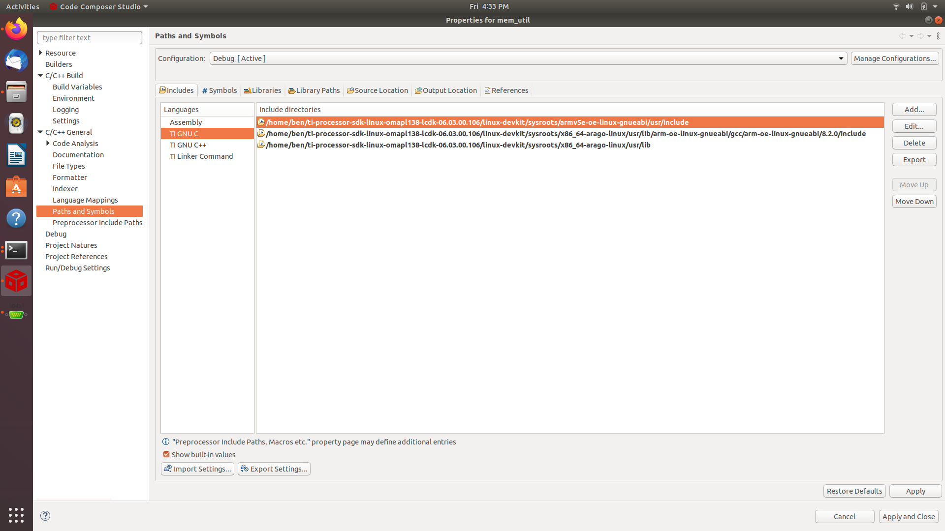

I have an OMAP-L138 LCDK dev board and Linux SDK v6.03 installed on my computer.
I've been experimenting with the dev board and my next step is to get a program which I compiled in CCS executing on the dev board.
I decided to try one of the example programs from TI as a starting point and chose the mem_util program.
However, when that program is compiled (with no changes) the below error message is output from the console:
mem_util.c:40:10: fatal error: stdio.h: No such file or directory
At the top of the file is #include <stdio.h>
However, if #include <stdio.h> is modified to #include "stdio.h" the compiler finds it, but then other #include <...> statements fail.
Where is the compiler expecting to find #include <stdio.h> as oppose to #include "stdio.h" ?

  • Even after including the include folders where say stdio.h exists, the compiler still complains about it the same way.
    Below is a picture of what folders were included for the build.
  • Ben,
    If stdio.h is in one of those 3 directories then gcc should not be giving a "no such file or directory" error.   CCS is just going to pass those directories with -I options to gcc.  You could scroll up in the console view and confirm that they are being passed to gcc.  In my gcc this file is located in:
    If you go to the line in your first screen capture and hit F3 does it open stdio.h?
    I believe this verison of gcc comes with the SDK.  I will see if someone familar with the SDK can assist.

    I gave the IDE the location "/home/ben/ti-processor-sdk-linux-omapl138-lcdk-06.03.00.106/linux-devkit/sysroots/armv5e-oe-linux-gnueabi/usr/include"
    I will check what the I option has.
    Ben

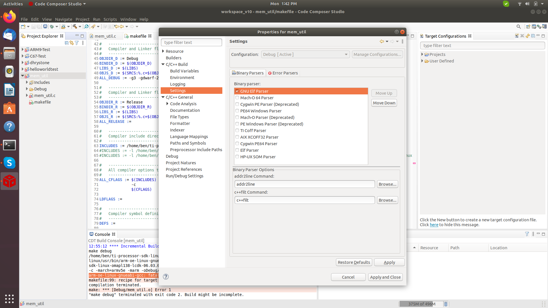

  • Hi John,
    I do not have the same menu structure as your setup (see below).
    I think this is because the compiler I'm sending the code to was not one that CCS is aware of and installed, it is for an ARM instruction set on the OMAP-L138.
    Is there an area that I can manually specify the paths for the I option?
    Ben
  • In the tree on the eft Go to C/C++ Build.  Then Settings.
    This should make the right side look like my last capture.  You can then select Directories under gnu compiler.
    John

  • Ben,
    Where did this project come from?  I just created a new non-CCS project and I am still able to set these options:
    In your case the Tool settings, Build steps and Build artifact tabs are missing.
    Do they show up for that ARM9-Test project you have?
    John
