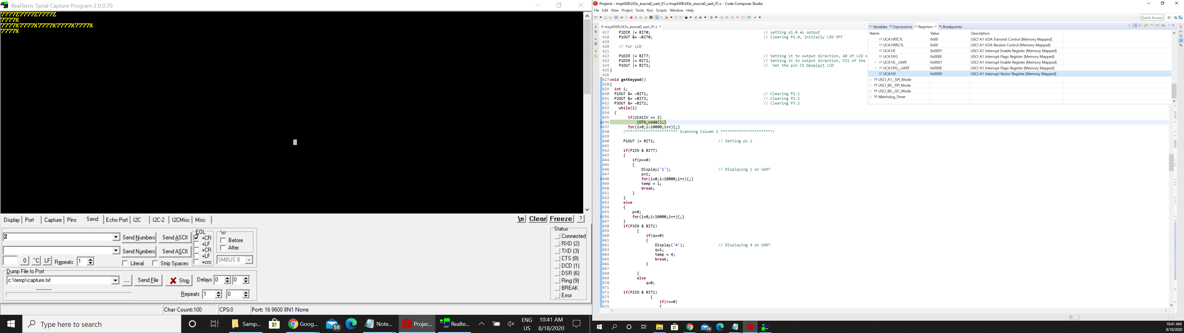

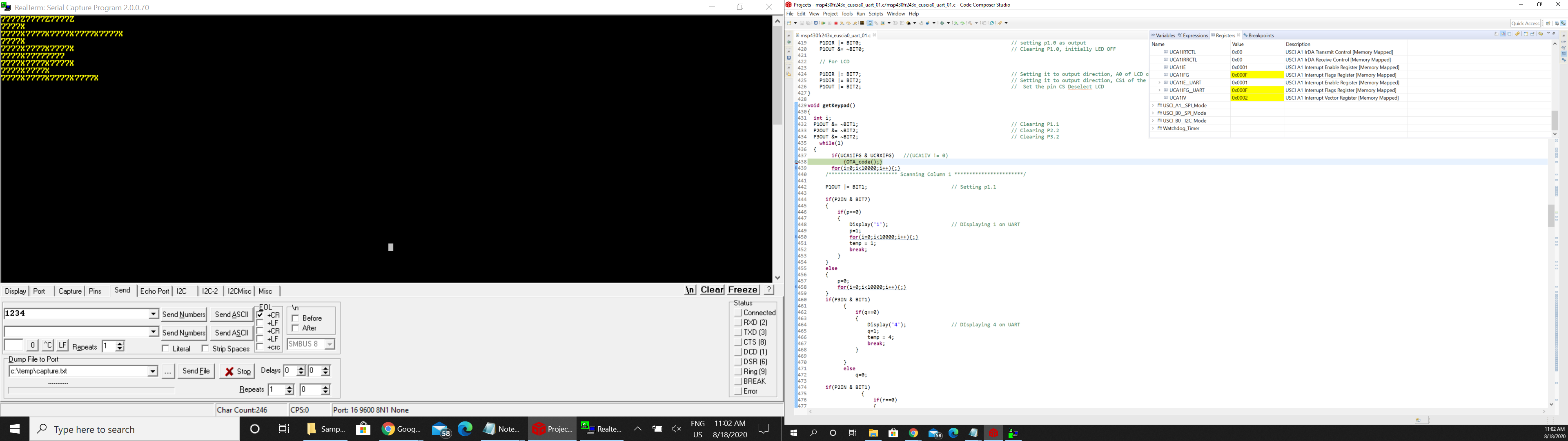

Hello
I currently have a micro that can read a number that is given by a user via a keypad. Then this number is sent via UART1 to my PC (Real Term). So far it all works just fine. No issues.
Now I want to send a code via PC (Real Term) to the micro as well. So I want to implement custom interrupt. The compiler spends most of its time in an infinite loop function called Keypad(); waiting for the user to press any button on the keypad. In this infinite loop, I implemented the following interrupt:
if(UCA1IV == 2)     // if a character is received by the RX buffer
 {OTA_code();}      // call this function. This function will read the Rx buffer.
But for some reason, this never gets triggered. I have attached the complete code to this message. Please refer to lines 139-146 and 433-440. I have connected a scope and see that the Rx of micro is getting the data. Not sure why the interrupt isn't working.
Thank you

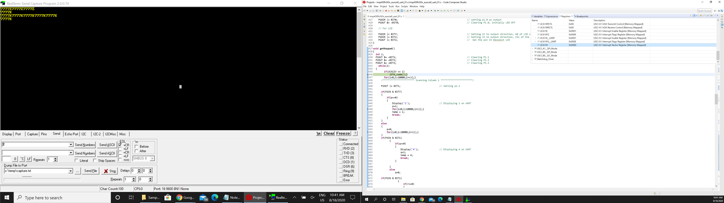

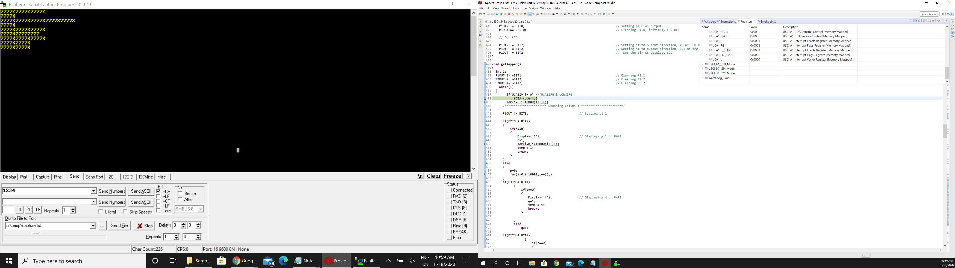

  • How do you tell that it isn't triggered? A breakpoint in OTA_code?
    Since you set UCRXIE and never enable interrupts (GIE) I would expect it to trigger. Do you get the same result if you test "if (UCA1IFG & UCRXIFG)"?
  • Hello
    Yes. I have a breakpoint in the If statement. Also another breakpoint in the OTA_code function. None of them get triggered when I send data from the Real term.
    I tried if (UCA1IFG & UCRXIFG) this instead of if(UCA1IV == 2)  and got the same result.
    I found a new issue with this. It is getting triggered when I enter a code via the keypad. When I enter a code which is saved on FRAM, the micro toggles LED1 (P1.0) and sends the code entered with an end character "X". Eg: If I enter, 7777, I see 7777X on my Realterm. However, in the OTA_code function, I'm transferring what's on RX buffer to a variable RXData and I'm seeing "X" in RXData. I commented on Sending the "X" part of the code and see that RXData is getting 7. So the last character that's being sent in the TX buffer is ending up in the RX buffer for some reason. I can't understand how its possible.
    Its getting triggered when I sent data via TX buffer and not getting triggered when I send data via Real Term. UCA1IV is 2 when the RX buffer is full. I'm using this comparison. I just don't know what I'm doing wrong.
    I have attached a few screenshots Bruce which might provide a better understanding of what I'm talking about.
    Varun R

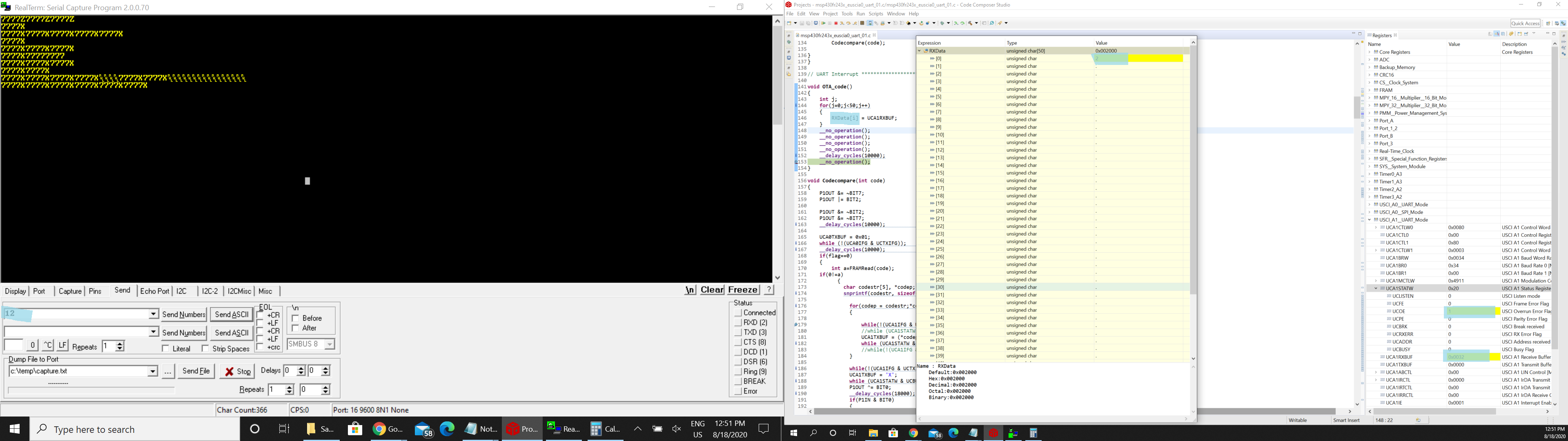

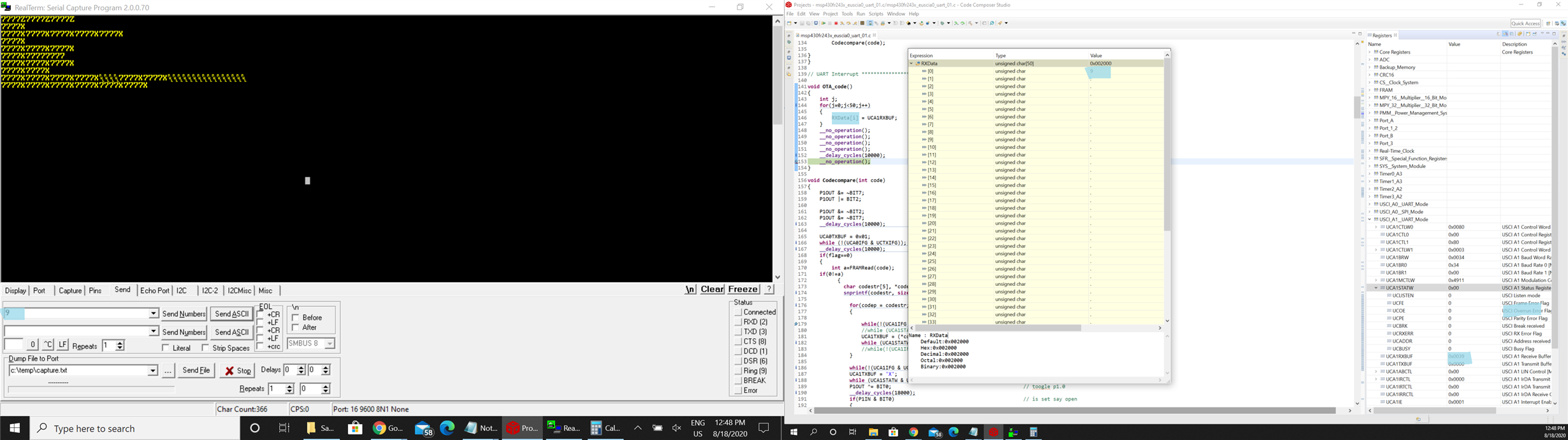

  • Hello Bruce,
    I found the problem and fixed it. This was the culprit UCA1STATW |= 0x0080;
    This sets the loopback function. That's why data on TX buffer was getting on Rx buffer and the RX was avoiding the data its getting externally as it is looped to the TX line. Once I fixed this, the interrupt was triggered. Sometimes copying example codes might backfire.
    Now I'm able to read a number that I'm sending from the Real term. But the problem is, I can only read one number. I tried sending 2 digits and the overrun flag got set and seems like the code is always reading the last digit sent. I tried 6 digit number and got the 6th digit only.  I declared an array of 50 to capture 6 digits but the compiler seems to miss the digits for some reason.
    I have attached screenshots of this issue.
    Varun R
  • 1) OTA_code is looping on "j", but storing into RxData[] using "i", which is loop-invariant, so it's storing over the same location.
    2) That loop doesn't pause for another Rx byte to arrive, so it will read the same value from RXBUF each time. You should add:
    > while (!(UCA1IFG & UCRXIFG)) /*EMPTY*/;
    before reading for the second and subsequent times. Reading UCA1IV clears RXIFG, so you mustn't check the first time.
    If you change your (UCA1IV!=0) condition to (UCA1IFG & UCRXIFG) you don't need to special-case the first RXBUF read.
  • Thanks Bruce,
    I'll try these out and let you know.
    Varun R
  • Hello Bruce,
    I tried what you suggested. It works now but I had to make few changes on how I sent the data to the micro.
    This is the interrupt call:
    if(UCA1IFG & UCRXIFG)
    {OTA_code();}
    This is in the interrupt function:
    for(j=0;j<6;j++)
    RXData[j] = UCA1RXBUF;
    The first time I send data(1234), I was only able to capture 4 and the compiler got stuck in the infinite while loop. I had to send the same data for the second time, then the compiler got out of the loop and I got RXdata[4] = {4,1,2,3}. Clearly it got overrun.
    Now I modified the data as $1234%, where $ is the start bit, then 1-sec delay, then 1234% where % is the stop bit. Now I'm capturing the data as I wanted. RXData[6] = {$,1,2,3,4,%}. When I write this array into FRAM, I'll discard '$' and '%' and store it as 1234. A server will send the data to this micro via modem, I can program the modem to send the data this way. It's not a problem.
    Do you think this is a good way or am I making my modem compensate for my bad code? I have attached the whole code to this email as usual.
    Thank you
    Varun R
