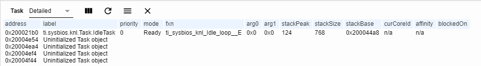

Before I start my application, I can look at the ROV>Task module and see:
 I run the application and when I stop it and look at the ROV>Task module and I see:
Error: java.lang.Exception: Target memory read failed at address: 0x200057d0, length: 76 This read is at an INVALID address according to the application's section map. The application is likely either uninitialized or corrupt.

  • It looks like my snapshot didn't make it through so I'm attaching the file here:

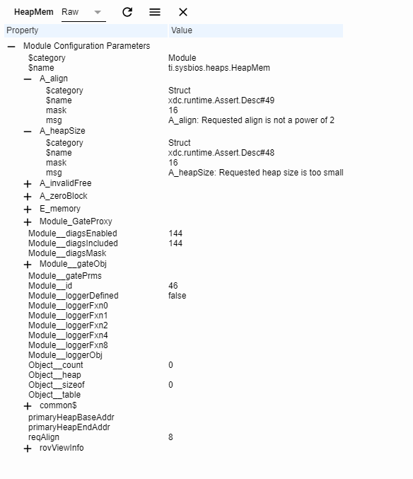

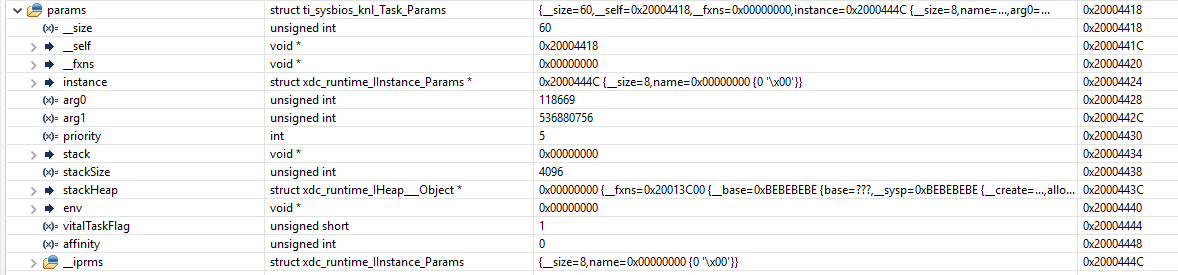

  • One last thing to check. What is the stack size of the task being created in the call? Are you supplying the stack or letting the kernel allocate it (e.g. is arams->stack set or not) How much memory is left in the heap (ROV->HeapMem). It could be that you are running out of memory.
  • The params->stack is set to 0 so it must not be supplied.  The stack size is 4K.  Here's a snapshot of the params:
    When I bring up ROV>HeapMem>Basic, it says "No data to display".  ROV>HeapMem>Raw shows:
    To me, this looks like the heap is not created yet.  If that's true, I don't know how anything is working correctly.  What are your thoughts?
