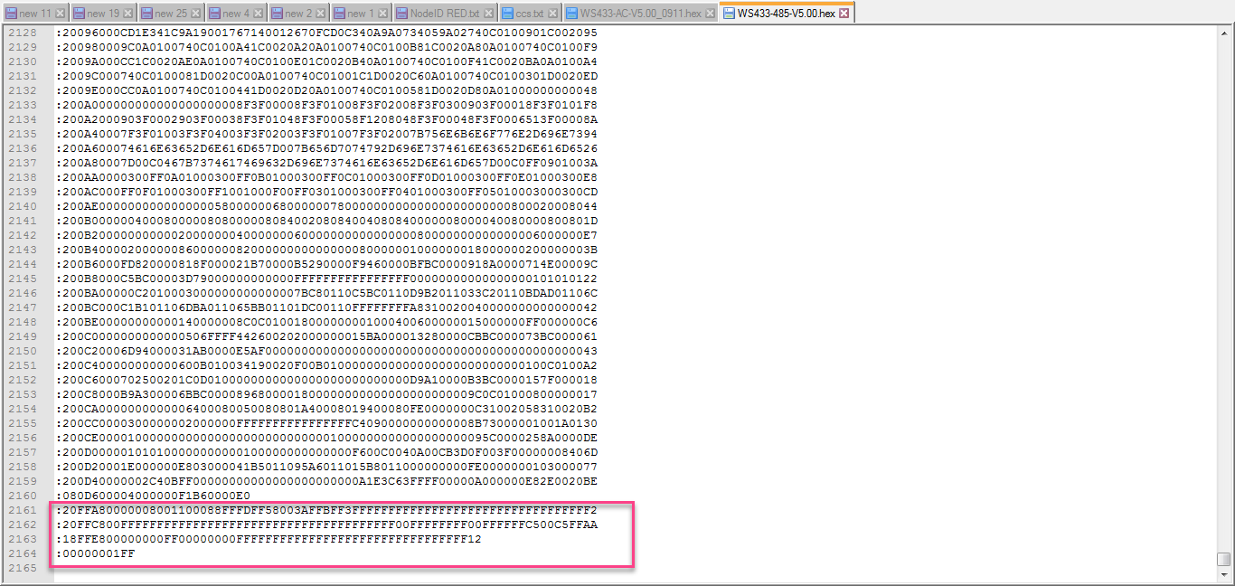

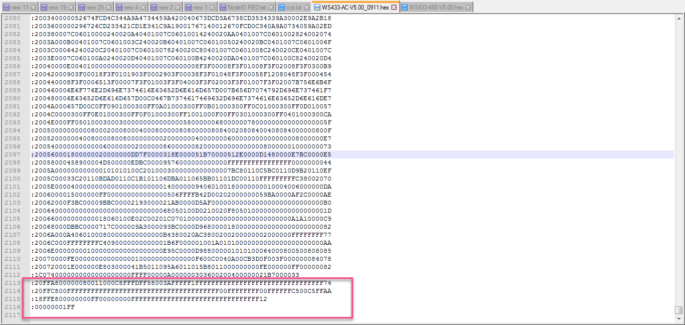

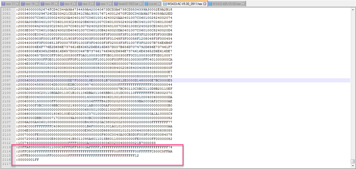

  •   Hi , M-W
    We noticed in the end of all the hex file which the CC1310 can enter LPM is
    :20FFA800000080011000C8FFFDFF58003AFFFFF1FFFFFFFFFFFFFFFFFFFFFFFFFFFFFFFF74
    :20FFC800FFFFFFFFFFFFFFFFFFFFFFFFFFFFFFFFFFFFFF00FFFFFFFF00FFFFFFC500C5FFAA
    :18FFE800000000FF00000000FFFFFFFFFFFFFFFFFFFFFFFFFFFFFFFF12
    :00000001FF
    and  in the end of all the hex file which the CC1310 does not enter LPM is
    :20FFA80000008001100088FFFDFF58003AFFBFF3FFFFFFFFFFFFFFFFFFFFFFFFFFFFFFFFF2
    :00000001FF
    So we replace the end of the hex file which the CC1310 does not enter LPM with the end one of the hex file which the CC1310 can enter LPM.
    Then we flash this modified hex => the CC1310 now can enter LPM.
    Khoa.
