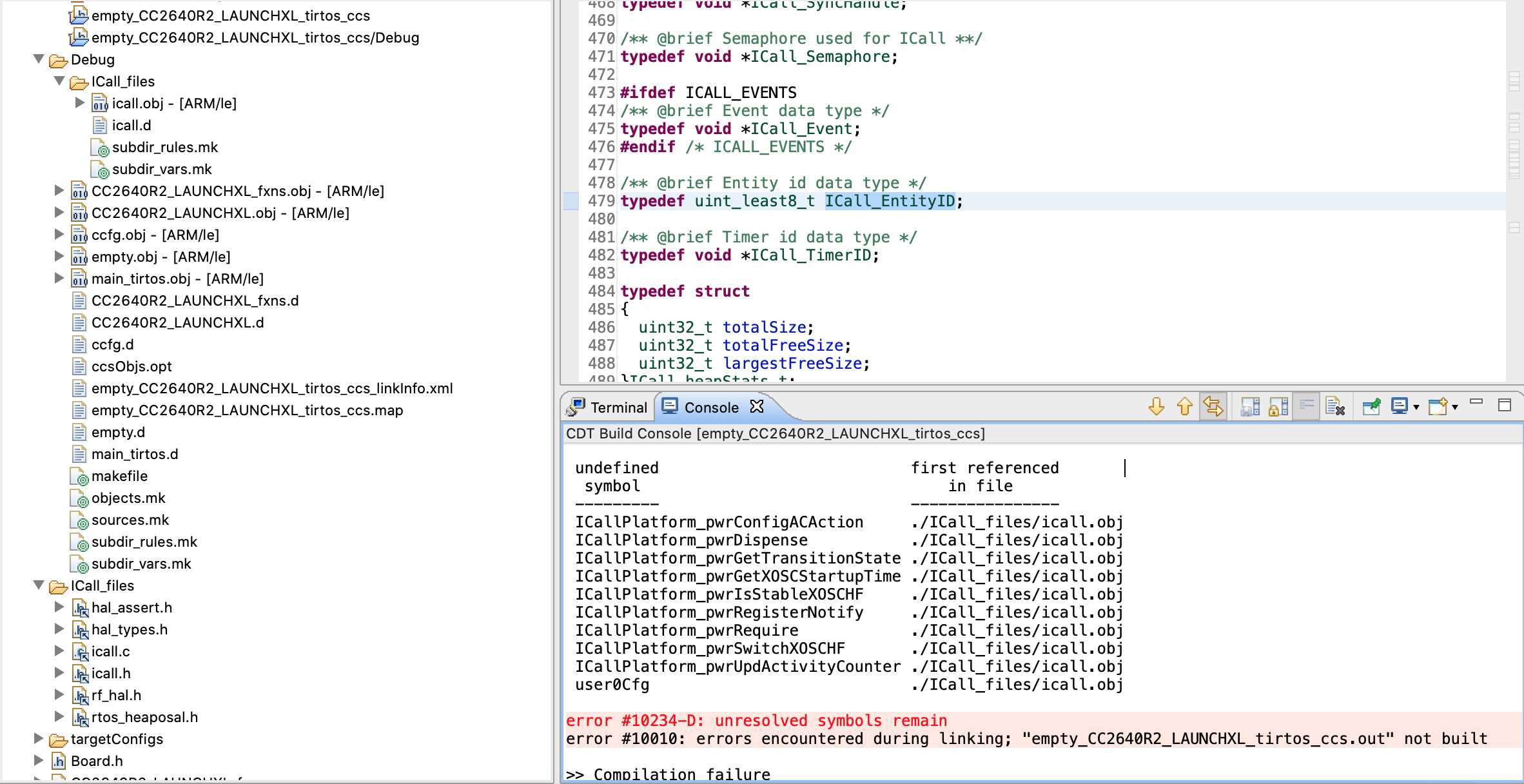

Im trying to include the ICall Interface to my empty_project example. Therefore I linked the necessary ICall files and gave the path in the Include Option.
However now im getting an error related to ICall .obj files. The Information that I found on related questions (such as include the <dir> File Search Path from the section ARM Linker) was not enough to solve my problem.
I attached a screenshot of what my CCS looks like.
The Compiler yield the following error(see image):
 undefined                           first referenced
  symbol                                 in file
 ICallPlatform_pwrConfigACAction     ./ICall_files/icall.obj
 ICallPlatform_pwrDispense           ./ICall_files/icall.obj
 ICallPlatform_pwrGetTransitionState ./ICall_files/icall.obj
 ICallPlatform_pwrGetXOSCStartupTime ./ICall_files/icall.obj
 ICallPlatform_pwrIsStableXOSCHF     ./ICall_files/icall.obj
 ICallPlatform_pwrRegisterNotify     ./ICall_files/icall.obj
 ICallPlatform_pwrRequire            ./ICall_files/icall.obj
 ICallPlatform_pwrSwitchXOSCHF       ./ICall_files/icall.obj
 ICallPlatform_pwrUpdActivityCounter ./ICall_files/icall.obj
 user0Cfg                            ./ICall_files/icall.obj
error #10234-D: unresolved symbols remain
error #10010: errors encountered during linking; "empty_CC2640R2_LAUNCHXL_tirtos_ccs.out" not built
>> Compilation failure
makefile:156: recipe for target 'empty_CC2640R2_LAUNCHXL_tirtos_ccs.out' failed
gmake[1]: *** [empty_CC2640R2_LAUNCHXL_tirtos_ccs.out] Error 1
gmake: *** [all] Error 2
makefile:149: recipe for target 'all' failed
**** Build Finished ***
    May I suggest you to take a different approach to achieve this? I think it would be way easier to start from the simple_peripheral example instead of the empty example.
    In short, the amount of files and configuration to add to the empty project to get a BLE capable project is basically too big to be worth.

  • Is just that I wanted to try to build a project by my self and Empty_project is the most basic project with which I can start. As the description says: ” This example is intended to be a starting point for new development”
    But if you mean that it will be too much work to add the configuration and files, then alright. That will be as you say, way easier.
