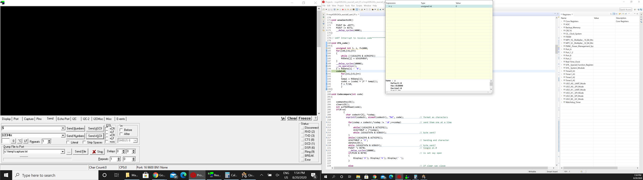

Hello
I have a char array "RXData[6]" which has a start but 4-digit data and a stop bit. Eg: $1234%. From this, I need the no 1234 to be stored into an int variable "Code". My program is as follows:
unsigned int j, z, f=1000;
for(j=0;j<6;j++)
while (!(UCA1IFG & UCRXIFG)) /*EMPTY*/;
RXData[j] = UCA1RXBUF;
__delay_cycles(10000);
__no_operation();
//z = (int)(RXData[1]);
code1=0;
for(j=1;j<5;j++)
temp1 = RXData[j];
code1 = (code1 + (f * temp1));
f = f/10;
The above code doesn't work because RXData is char and I need it to be in Int. I tried converting it to int (z = (int)(RXData[1]);) but this doesn't work. I tried 'otai' function as well but it's not recognized. How do I go about this conversion?
Thank you
Varun R
  • What error do you get? You should have no problem casting a char to an int.
    However, you may need to convert from *ASCII* to int. Do this like this:
    z = RXData[j] - '0';
  • I don't get any error. The compiler just skips that line. I have a breakpoint 2 lines before the conversion, and I'm doing step over till I hit that line and its just skips that line. So it's not getting converted.
     Am also getting a warning that z was never used but we are using it. The compiler is just skipping it. Any particular headers I should include? I have the following headers:

    I have attached a screenshot and my whole code as well. Please refer to line 180-198.
