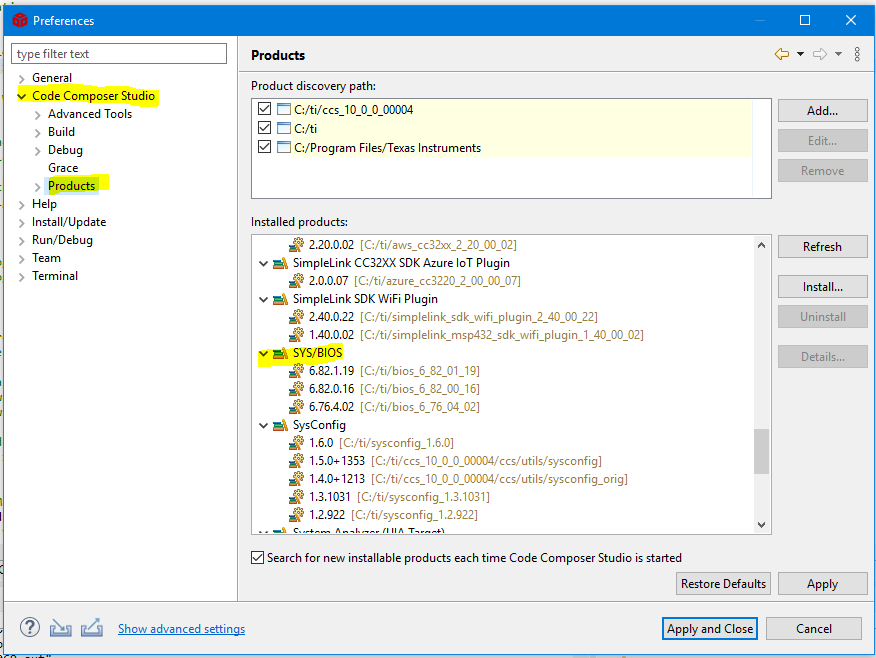

  • Hi Andrew,
    Can you look in your Windows->Preferences to see what products are installed.
    If you don't see SYS/BIOS, please install one in c:\ti. The download site is here: http://software-dl.ti.com/dsps/dsps_public_sw/sdo_sb/targetcontent/bios/sysbios/index.html
    Start CCS and let it discover the product. After installing, you'll be prompted to restart CCS. You should get the examples after this.
