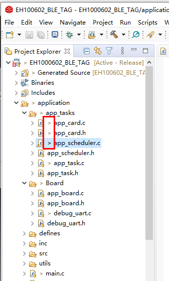

Hi, here are some arrows before source file as below:
Some files have arrows, some files have no arrows.
What do these arrows mean please?

They are "Label Decorations" for projects which are under GIT or SVN version control. By default an arrow means the file is "dirty" and the local file has modifications compared to that under version control.yingtao jia said:What do these arrows mean please?
You can see the "Label Decorations" under Team preferences in CCS. E.g.
