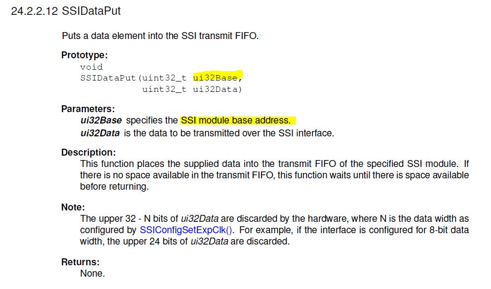

     SSIDataPut(SSI3_BASE, pui32DataTx1[ui32Index]); // Already has SSI3_BASE to get the Data so where is the API to use SSI3DataPut??
    There is no such API like SSI3DataPut or SSI1DataPut or SSI2DataPut.  The See below API description.
      I will suggest you try a more simpler example: <TivaWare_Installation>/examples/boards/ek-tm4c1294xl/ssi_master_slave_xfer. This example transfer data between SSI0 (master) and SSI1(slave) one bit at a time instead of in Quad mode. Whether you use ssi_master_slave_xfer or ssi_quad_mode example, please run them as is and make sure they work before modifying them. Another note is that if you change them to SSI3 and SSI2, you need to make sure the interrupt vectors for the new SSI instances are properly updated in the vector table. The vector table is in the startup_ccs.c file. See below example done for SSI1.. If you are going to use SSI2 as the slave you need to setup the ISR vector for SSI2.

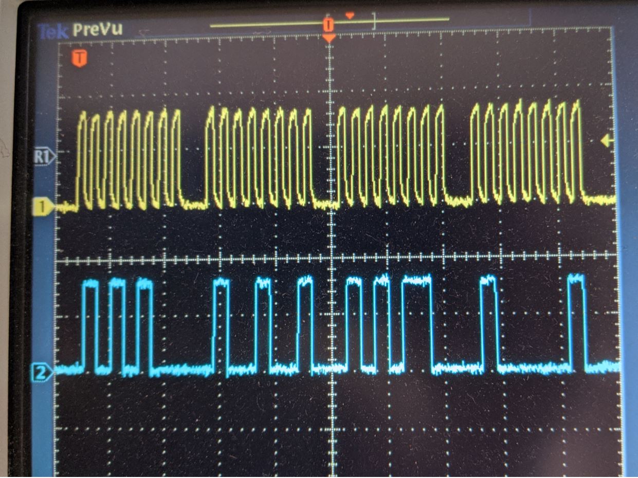

      What board are you using. I just run the example as is, not modifying anything. I probe the PA2 (SSI0CLK) and PA4 (SSI0TX) and I don't see any issue. See below. Do you have another board that you can try?
