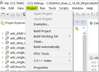

  • Did you import the project in the CCS from "File" -> "Import"? Can you compile the project?
  • No I imported from "Project"->"Import CCS projects".
    Yes I can.
    Andor
  • What do you mean you import from "Project"? There is no "Import" under the "Project".

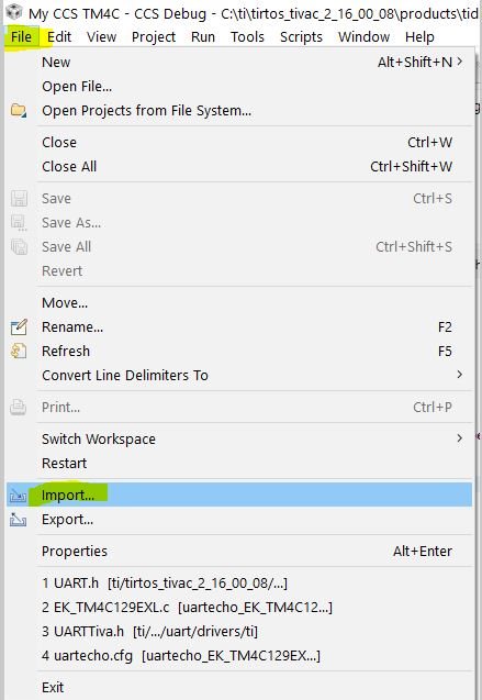

    Below is what I meant to "File"->"Import" the project.
    In any case, you seem to import the project and compile it fine.
    This project uses the UARTprintf to output the status of the operations. You need to open a virtual COM port to view the status. You should see something like below in your terminal window.
    If you look at the code I think you are in the SimpleDelay as shown on your disassembly window. The code for the can_simple_tx is supposed to keep sending data on the CAN bus every second. If it is not sending continuously then it means that the receiver is not acknowledging the data. You need to check if you receiver is setup on the network. If the transmitter is not successful sending the data (see theCANStatusGet), then it just got stuck.
