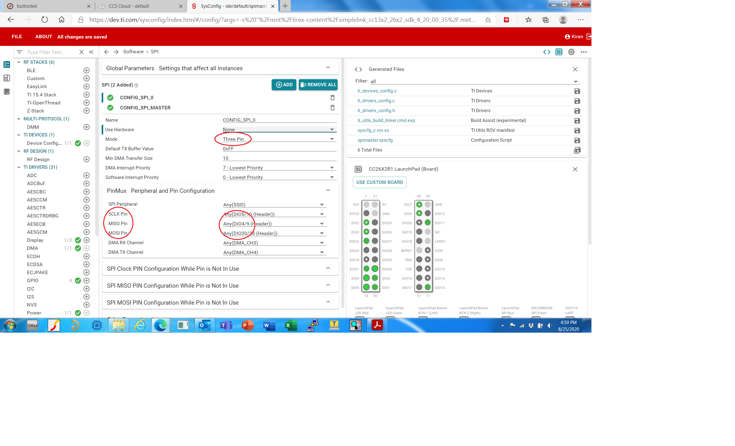

In Code Composer 3-wire SPI interface section, selected pins are SCLK, MISO and MOSI. Please see attached.
But in industry standard 3-wire SPI interface, pins are CS, SPC and SDI/O. Please see attached.
These are different from one in Code Composer. In Code composer there is no CS pin.
In industry standard 3-wire SPI interface MISO and MOSI are combined into a single pin SDI/O.
How do I fix this issue in Code Composer.

    Unfortunately the 3-Wire half-duplex SPI mode isn't available in hardware on this device. The 3-wire mode here refers to the user controlling the CS line manually. You may be able to write your own driver or bit-bang a solution using the Sensor Controller on the device to achieve half-duplex 3-Wire SPI mode.

    What I meant is that in the SPI 3-Wire mode shown in SysConfig in your screenshot above is a SPI mode where CLK, MISO, and MOSI are controlled by the SPI peripheral and the CS/SS pin is controlled by the user manually in their code. Typically this would be a GPIO you configure and toggle high and low as needed.
    In the case of using multiple devices on a single SPI bus you would use 3-Wire mode and add GPIO(s) as needed to toggle CS high and low for each device on the bus.
    This is different from the 3-Wire half-duplex SPI mode your 2nd screenshot where MOSI and MISO are shared on a single line.
    I hope that helps to clarify.
    Daniel

    Problem was with GPIO write instruction for CS to my sensor. Once that's fixed, it started working.
    I used RED LED (LED0 - DIO6) as chip select for my sensor. Then used LED0 OFF/ON instructions to enable and disable sensor.
    Then I used DIO11 with corrected write statements and problem was fixed.
