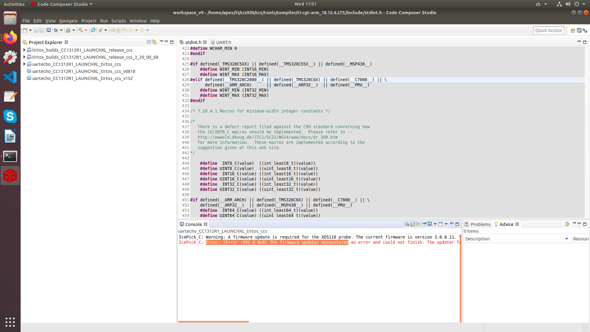

I have an LaunchPad CC1312R2 and MY CCS versio nis 9.3.
Due to some contrainst , i need to work on both WIndows and Linux enviroment.
My launchpad was able to work on Windows (same launchpad with CCS9.3).
However, i was not able to debug , THE problem of
it urge me to upgrade the XDS firmware but its always fail in upgrading.

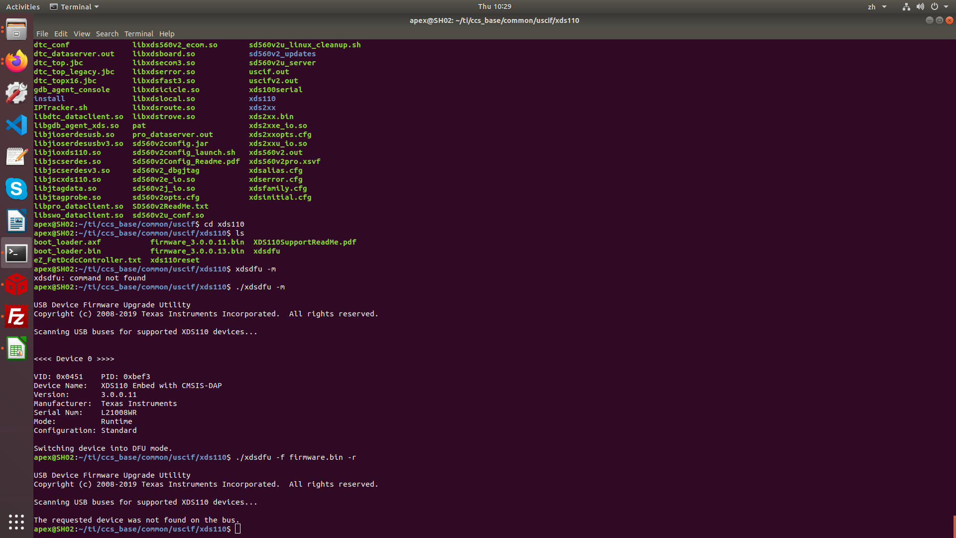

  • Hi Ki,
    PS i was not able to work on Linux and can able to work in windows.
    here the screeshot for the xds command
    apex@SH02:~/ti/ccs_base/common/uscif/xds110$ ./xdsdfu -m
    USB Device Firmware Upgrade Utility
    Copyright (c) 2008-2019 Texas Instruments Incorporated.  All rights reserved.
    Scanning USB buses for supported XDS110 devices...
    <<<< Device 0 >>>>
    VID: 0x0451    PID: 0xbef3
    Device Name:   XDS110 Embed with CMSIS-DAP
    Version:       3.0.0.11
    Manufacturer:  Texas Instruments
    Serial Num:    L21008WR
    Mode:          Runtime
    Configuration: Standard
    Switching device into DFU mode.
    apex@SH02:~/ti/ccs_base/common/uscif/xds110$ ./xdsdfu -f firmware.bin -r
    The requested device was not found on the bus.
    thanks
    Jeff
  • Jeff, sorry for the delay. When you run:
    ./xdsdfu -e
    What is the output?
