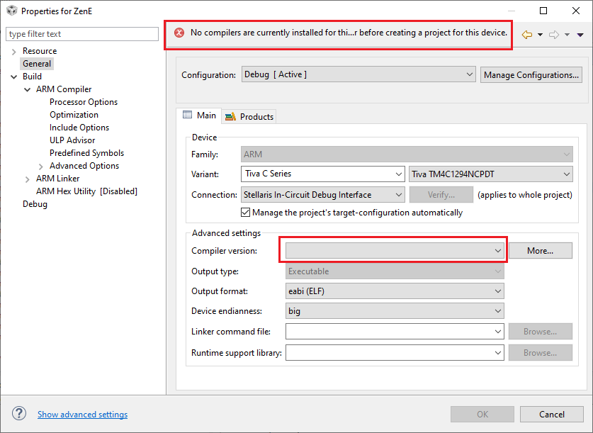

I am unable to select TM4C1294NCPDT as the controller while creating a new project in CCSV6.2. Its just not there in the options.

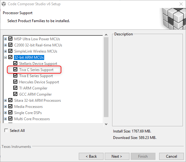

    Sounds like you 6.2 installation is missing Tiva C support. Try re-running the 6.2 installer over your existing 6.2 installation. This will allow you to add additional components. Make sure you select the option for Tiva C.
    ki
  • Hi Ki,

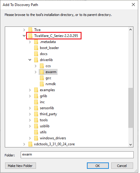

    Thank you for your reply. So I had to re install CCS6.2 with support for Tiva C series. Now it shows the Tiva Controller but it does not show the compiler to be used for it. So I downloaded the TivaWare_C_Series_2.2.0.295 package. Could you please point me to the path for the compiler in this folder? I am attaching the screen shots where the TivaWare package is installed.

  • It looks like CCS is not detecting the ARM compiler. It should get installed if you select Tiva C during installation.
    Go to <CCS INSTALL DIR>\ccsv6\tools\compiler. Do you see any folders in there? There should be one for ARM.

    I don't see a compiler directory actually. But I installed the compiler separately and pointed to it in the "properties" window.
    Apparently it works... except for the fact that I am getting a whole lot of errors and warnings which were originally not there.
    I am now manually feeding the File search path of each folder in my project. Looks like it is fixed for now. Thanks for your help.
