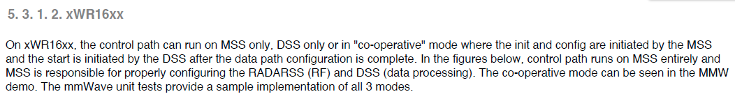

Hi there,
I notice in the SDK, TI documents that the control path can run on the MSS entirely on its own (without running the DSS in the "co-operative" mode) to configure the RADARSS (RF). The mmWave unit tests provide sample implementations.
1) Is there a way to disable the DSS entirely and solely run on MSS to configure RADARSS in the mmwdemo version?
2) If not, where are the sample implementations that the SDK mentions? And are those BIN files that I can flash on to the AWR?
Thanks!
George
  • Hell George,
    Please refer the mmwavelink test application where it does all the BSS configuration from MSS only.
    And for Generating metaImage you need to provide NULL instead of DSS image path in the metaImage script (in ccs project properties).
    Jitendra

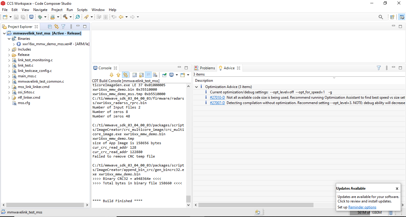

  • Hi Jitendra,
    Thank you for the info. I spent all day today trying to figure out how to do this, but I was not able to get it. Could you help me with the steps (on how you see yourself accomplishing something like this) before doing the build steps that you recommended at the bottom of your last post?
    I have CCS downloaded and I know where to find the MSS and DSS in the automotive toolbox, but I do not think I want this. I think I want to start a new project. But when I start a new project, it is a completely clean slate.
    How do you import the necessary documents (to build the project) for the mmwave link Test application? I think I found the SDK by going to Project properties and then adding in the file directory for the SDK, if that is correct? Would you recommend going off of this test application and then dragging over the lvds c file from the mmwave demo into this project?
    And your understanding of my project is correct. I just need to configure the front end of the radar (BSS) and send the received data to the DCA1000 to my Raspberry which is ready and configured to write down the raw ADC data. Also, if there is a way to do this for the AWR1642, could you tailor the steps to the AWR1642? I have a 502AC version of the chirp with 2.0 SDK currently flashed on it, but I think 3.4 could work? Right?
    Any more direction would be really really appreciated!
    George
  • Hello George,
    I have attached the CCS project for mmwavelink_test application where it includes only MSS part of the test application.
    And it generates the MetaImage containing MSS and BSS firmware in it.

  • Hi Jitendra,
    Thanks for sending the project, that is really helpful. I was able to load in the project, fix all of the errors, and clear all the warnings. I did receive some optimization advice notes as seen below with the exact project you sent me... Are they necessary? What would you recommend doing, if anything?
    Also, since I do not have a debugger or anything to use to make sure my code runs as desired, is there anyway you could provide me some exact steps on how to add in the UART CLI and LVDS feature? Also, since I want to configure a [0 0 1 1] BPM scheme, should I also include the Advanced BPM CFG API as well? Should I just take the necessary c files from the sdk? Then what? Do they have to be included into the mss_main.c file in this test project? Laying out the steps would be so appreciated!
    Thank you so much! Almost there!!
    George
