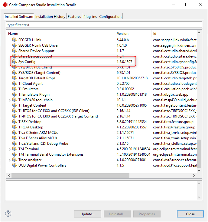

    What is the version of the SysConfig component? You can check by going to "Help -> About Code Composer Studio -> Installation Details" and the checking the version for "Sys Config":
    You need at least version 1.4 or greater.
