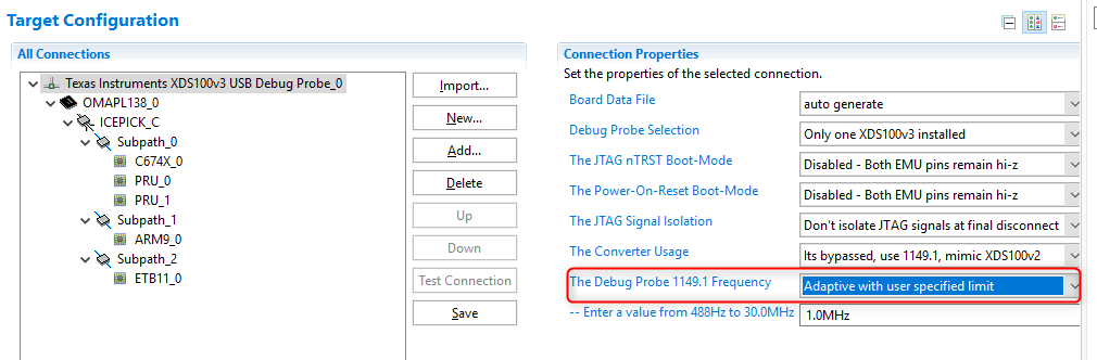

I'm trying to connect to the ARM9 inside the OMAP-L138 on the OMAP-L138LCDK dev board through an XDS100v3.
When the gel file from TI is launched prior to debug the below output is generated.
ARM9_0: Output:     Target Connected.
ARM9_0: Output:     ---------------------------------------------
ARM9_0: Output:     Memory Map Cleared.
ARM9_0: Output:     Memory Map Setup Complete.
ARM9_0: Output:     PSC Enable Complete.
ARM9_0: GEL: Error while executing OnTargetConnect(): Target failed to write 0x01C11138
     at (*((unsigned int *) (0x01C11000+0x138))|=0x1) [OMAP-L138_LCDK.gel:16]
     at device_PLL0(0, 24, 1, 0, 1, 11, 5) [OMAP-L138_LCDK.gel:403]
     at Set_Core_300MHz() [OMAP-L138_LCDK.gel:468]
     at Core_300MHz_mDDR_150MHz() [OMAP-L138_LCDK.gel:245]
     at OnTargetConnect()
I found the below thread which talks about this same issue, but I don't think the probe I'm using falls into the same category.
https://e2e.ti.com/support/tools/ccs/f/81/p/786780/2912086#2912086
Should it only be the J-TAG settings then that's the issue?

  • Further information after reading some other posts on the form here:
    The OMAP-L138 is configured to boot from SD card, SW 1 - 3 = OFF and SW4 = ON
    The SD card is removed from the device.
    Code Composer Studio Version: 10.1.0.00010
  • It could be an adaptive clocking issue:. What vendor is your debug probe from? Olimex?
    https://e2e.ti.com/support/tools/ccs/f/81/p/447241/1628422#1628422
  • Hi Ki,
    I'm not too sure at this point where we got the debugger from.
    The silkscreen on the debugger says Spectrum Digital Incorporated.
    Ben
    I assume then that you are using a Spectrum Digital XDS100v3 probe.
    Can you check your target configuration settings and see if "Adaptive with user specified limit" is selected?
    ki

  • Hi Ki,
    My setting for The Debug Probe 1149.1 Frequency was set to "Fixed Default at 1.0 MHz".
    Once I set it to "Adaptive with user specified limit" the debug probe successfully set the gel file memory register values.
    The code can now load and execute.
