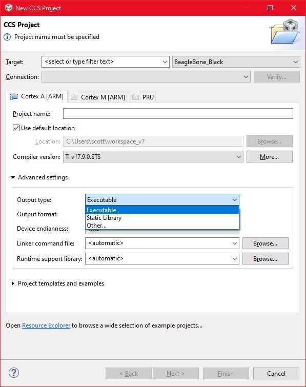

Once upon a time, I could create a SysBios based project.   Magically that seems to have disappeared.
I am using CCS 7.2.   Simply go to "Project | New "  and see that the only templates are "empty project.".  My target device is the BBB.  A dozen or more other projects are based on the BBB, and DO have SysBios as their project type.
However, select the "Cortex M"  and see that it DOES give you options for SysBios...

  • Oh look...
    CCS did not "magically" take it away. It just changed my default output type.
    CCS changed the default to be a static library.
    Why it changed it, since I do not make static libraries, and why it thinks it can or should try to use a template that has a "main()" in a static library is beyond me...  or for that matter any of the other templates.
    Changing it back to executable let the other templates show up.
