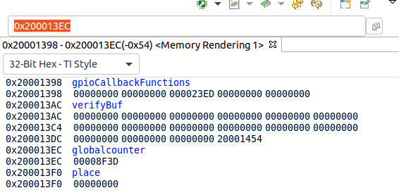

I have a program which loops through a task at a specifc interval. I have made a global variable while debugging to check how many times it has iterated through the loop.
Recently though, instead of counting up to 1 the first time it counts up to 61. This is due to the verifyBuf overflowing into it. What, when and how are this buffer filled?
I have difficulties finding out what the verifyBuf actually does and why it all of a sudden starts to overflow.

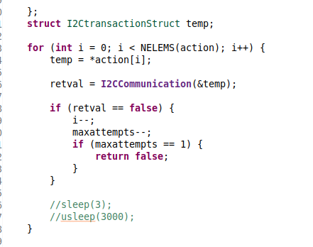

The program is simplified a CC1310 communicating with a MSP430 via I2C. A list of approx 30 struct containing the necessary data is run through a loop, which calls a function that handles the I2C communication.
It is during this that the verifBuf is written to.

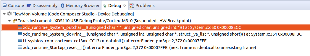

This is the call stack.
The memory browser:

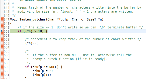

And the function in system.c that overwrites my variable
